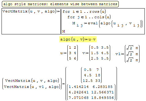

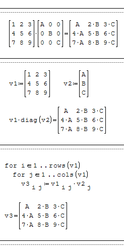

Construct your generalised vectorising algo.
Get inspired from the attached.

More generally:
1. accomodate rectangular systems
2. define your own multiplicand
3. assign the "algo" processing
Utilities Matrix Vectorise CreateVector.sm (12.75 KiB) downloaded 648 time(s).

1. Refactored a bit
2. Read more stuff and examples
Utilities Matrix Vectorise CreateVector.sm (21.25 KiB) downloaded 665 time(s).
