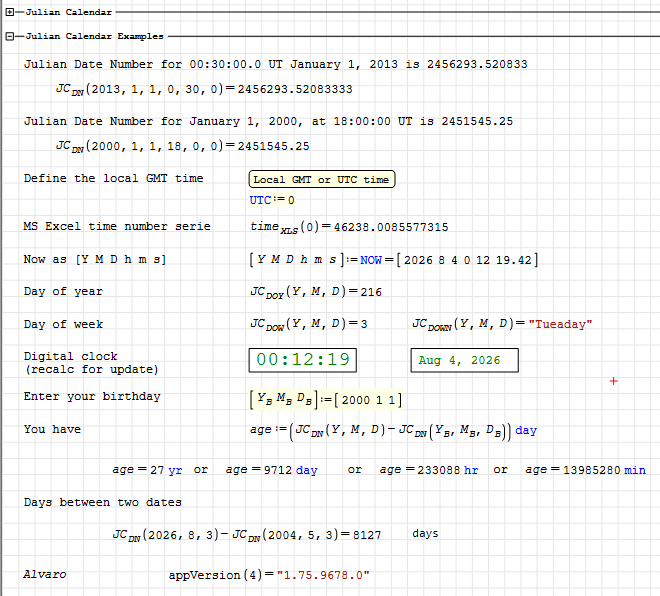

SMath Forum SMath Studio Questions Simple Date Calculation 1 Pages (2 items) Simple Date Calculation - Apologies I can't seem to find syntax for dates - Messages Go to last post #1 Posted: 2026/8/3 23:04:42 Alan O'Connor 0 likes in 1 posts. Group: User Just looking to calculate number of days between datesI feel I should be able to find this myself .... bit of a noob here #2 Posted: 2026/8/4 00:15:59 Alvaro 1,123 likes in 1,795 posts. Group: User Hi. You can try the tools in this post: https://smath.com/en-US/forum/topic/8UdBUE/Julian-Calendar-UtilitiesJulianCalendar.sm (41.79 KiB) downloaded 108 time(s).Best regards.Alvaro. 4 users liked this postRafael H Padilla Velázquez 2026/8/4 02:05:24, sergio 2026/8/4 08:23:39, ioan92 2026/8/5 07:35:37, NDTM Amarasekera 2026/8/5 14:19:55 1 Pages (2 items) New Posts No New Posts
