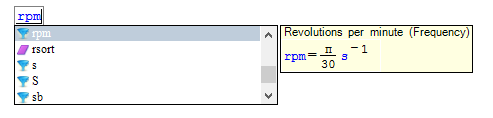

i calculated the Reynoldsnumber where i need the revolutions per minute. What struck me was the conversion from rpm to 1/s -> 60rpm = 1 rps = 1 s^-1. According to smath 60rpm = 6,28 s^-1.
Is there a bug or are i'm doing the math wrong?
thanks a lot!

please read here (SS-2395) (you can vote and comment it), here or here (and other...)
base unit of a revolution is coded as 2pi radians (not 1), hence the multiplication factor.

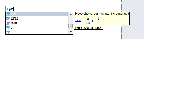

This is because the standard unit in SMath for rotation is radian = 2*pi which is ~6.28. If you look at the definition of rpm it is pi/30 1/s or 2*pi/60.
In order to get the right result you need to divide by 2*pi. What i would suggest is creating your own unit for RPMs as done in the attached.
