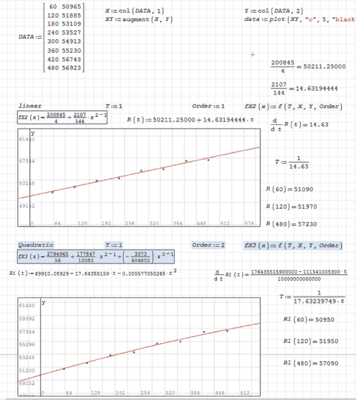

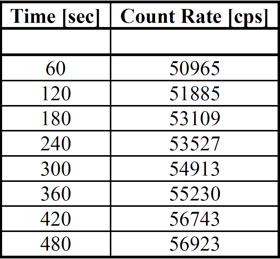

hi i have a table of values [R(t=60)=50965] with no obvious pattern and i need to create a function to fit into the formula
1/T = d (ln(R(t)) / dt
my thought was to make S(t)=ln(R(t)) and do d(S(t))/dt but i dont know how to turn a bunch of values into a function in smath and excel doesnt understand the function properly (i left out the last value and did auto complete and it was too far off)
R(t) is in counts per second
and i am solving for T

Start by creating the Smath data table,
Before going ahead, the wiggling around the straight fit,

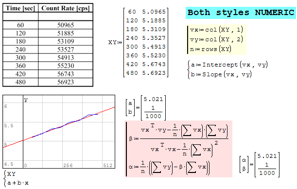

#6 Posted: 2019/11/27 21:14:47
... in your original scale XY.
Data.sm (40.67 KiB) downloaded 575 time(s).

#8 Posted: 2019/11/28 00:03:25
thank you so much
as much as I would like to say part b of the question I need to do my own homework I just couldn't understand how to get the equation of that line
1. You mean equation of the straight red line of the first plot ?
2. Or: the piece wise linterp between the support points ?
linterp, cinterp, ainterp are built-in Smath from f(x) menu.
The straight line in [1] can be manipulated a bit from statistical methods [Not Smath built-in].
Also, if you don't like the rough bifurcation at the supports
points, easy to fillet for smooth path.
No more need for the first replies before the last attachment,
then will be removed.

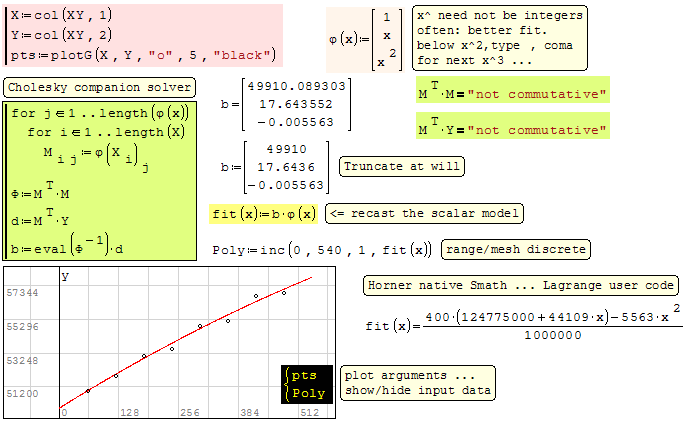

I think you can also use the least-squares method to find the equation that best fits your data.
Ajust_by_Last_Square_Selection_Engineering_studente.sm (62.08 KiB) downloaded 601 time(s).

#10 Posted: 2019/11/28 08:55:51
Here is Cholesky [Least Squares], otherwise.
Ge sensor [Germanium] is an exceptional application.
Genfit 0 Ge SubCryogenic.sm (39.2 KiB) downloaded 570 time(s).
