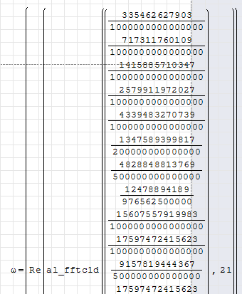

The problem seems that inside the functions stack/augment works in symbolical mode, and the input in symbolical mode is the one below, that is not managed by stack/augment (not sure if correct for symbolical calculations, bug or missing feature).
![2016-03-18 12_06_27-SMath Studio Desktop - [Fourier al_fftc1d_[ALGLIB][DEBUG].sm_].png](/zh-Hans-CN/files/Download/ZMPTB7/2016-03-18-12_06_27-SMath-Studio-Desktop---[Fourier-al_fftc1d_[ALGLIB][DEBUG].sm_].png)
You have to place an eval() inside fft2D to force a numerical result.
