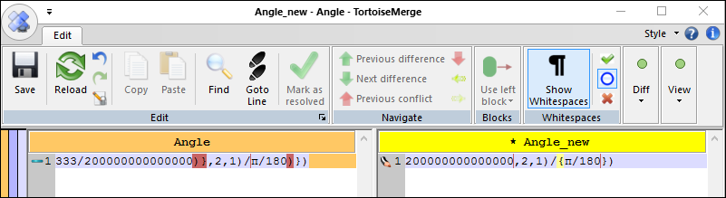

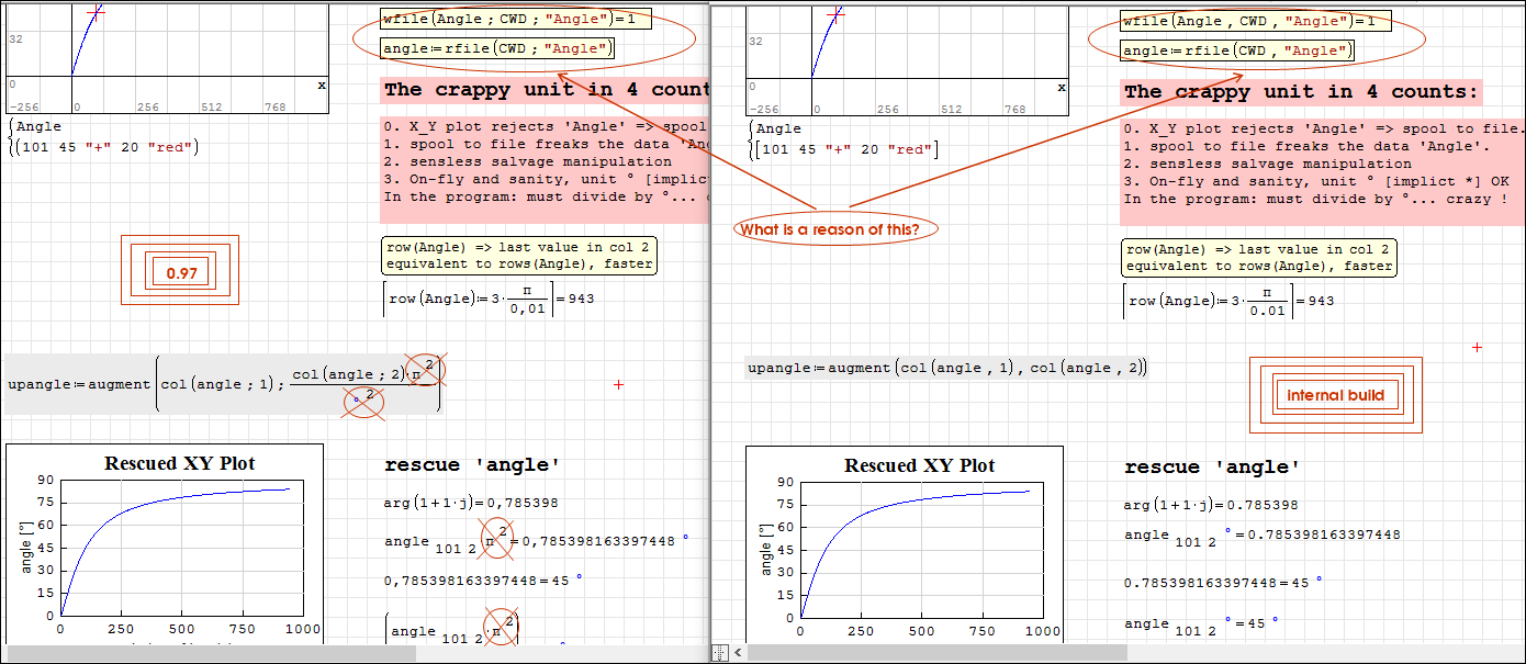

I want to ask you about one interesting issue I have found:
Error was found and now fixed in nightly build:
Please, could you comment about the reasons of rfile/wfile used?

Hello Andrey,
Everything OK Smath 5346. The original code was incomplete for the X_Y plot.
No need to spool to file. Corrected code in the attached work heet 5346.
