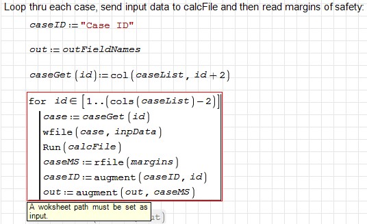

I get the error: "A worksheet path must be set as input" when running the Run() command. It runs fine with the example file "Run Example".
Any help please?

Assuming calcFile file path exists, should be because encoded strings. I?ll fix it ASAP.

"CalcFile" is defined by a string of the filename with .sm. The file is in the same folder as the master worksheet.

Fixed and released for the latest beta.

I've tried the Run() plug-in using SMath 0.99.7786.571 and it seems to be working.
Thanks very much for the prompt fix!
