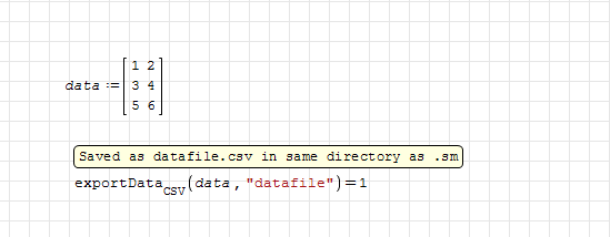

I am trying to write data to a csv file. On the forum, I have seen examples of output_CSV and “outputData (subscript CSV)”. I cannot get either to work. My data is a two column matrix.
If this function works in SMath, any help on the correct syntax would be appreciated. Perhaps it requires a plugin. If so where can I get the plugin?
Also,where will the csv file be located?
Thanks much.
Reg

You can use the data exchange plugin. To install go to Tools->Plugins... -> Click (Local Storage) and select Online Gallery -> Look for "Data Exchange" -> Double Click to install.
A simple example of exporting to CSV is shown below. Note: you will need to save the .sm before exportData function will work.
csvExport.sm (2.81 KiB) downloaded 1053 time(s).
Thanks again for all your help.
It still does not seem to work for me. I installed the Data Exchange Plugin and used the following syntax.
I keep my .sm files files in the following directory. C:\Users\Reg\Reg Documents\MATH_SMATH
The file was not located here.
It is also not located here: C:\Users\Reg\AppData\Local\Programs\SMath Studio
Alyles,
Thanks again. I discovered my issue. The = is a symbolic evaluation.
Thanks,
Reg
Thanks,
Reg
WroteThe = is a symbolic evaluation.
Not quite so ... =1 is logical answer "yes saved"
