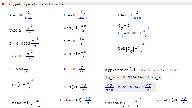

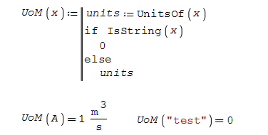

#8 Posted: 2022/5/19 08:28:50
1,443 likes in 2,935 posts.
I'm not sure, however if you need a urgent fix here you have an easy way to make it working the same way.
