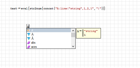

Is there a way to assign a description to a variable dynamically?
I am defining variable names dynamically. I would like to also assign a description with each variable name.
Is this possible?
Thanks

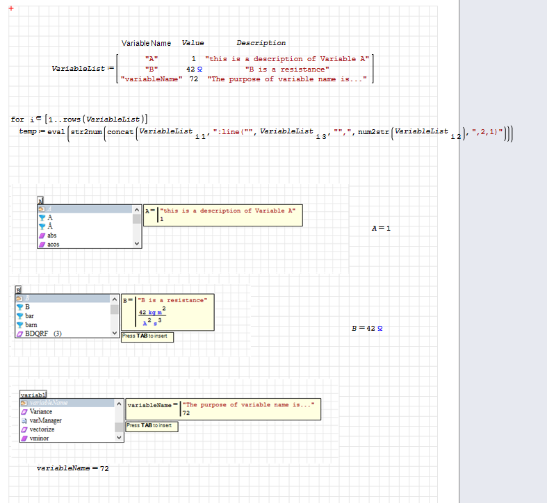

A matrix approach:
AssignValueAndDescription.sm (7.5 KiB) downloaded 1096 time(s).

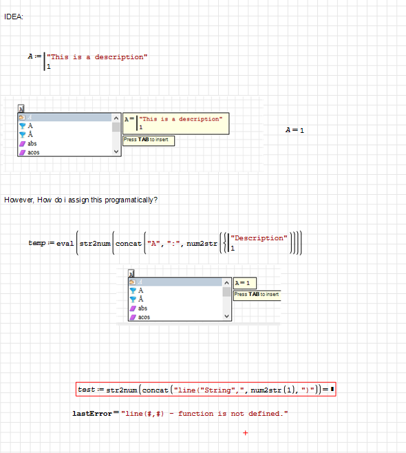

I had another idea using line function. But i'm not sure how to do it programatically... Any Ideas? Is it even possible?
Worksheet8_alternateIdea.sm (22.9 KiB) downloaded 1148 time(s).

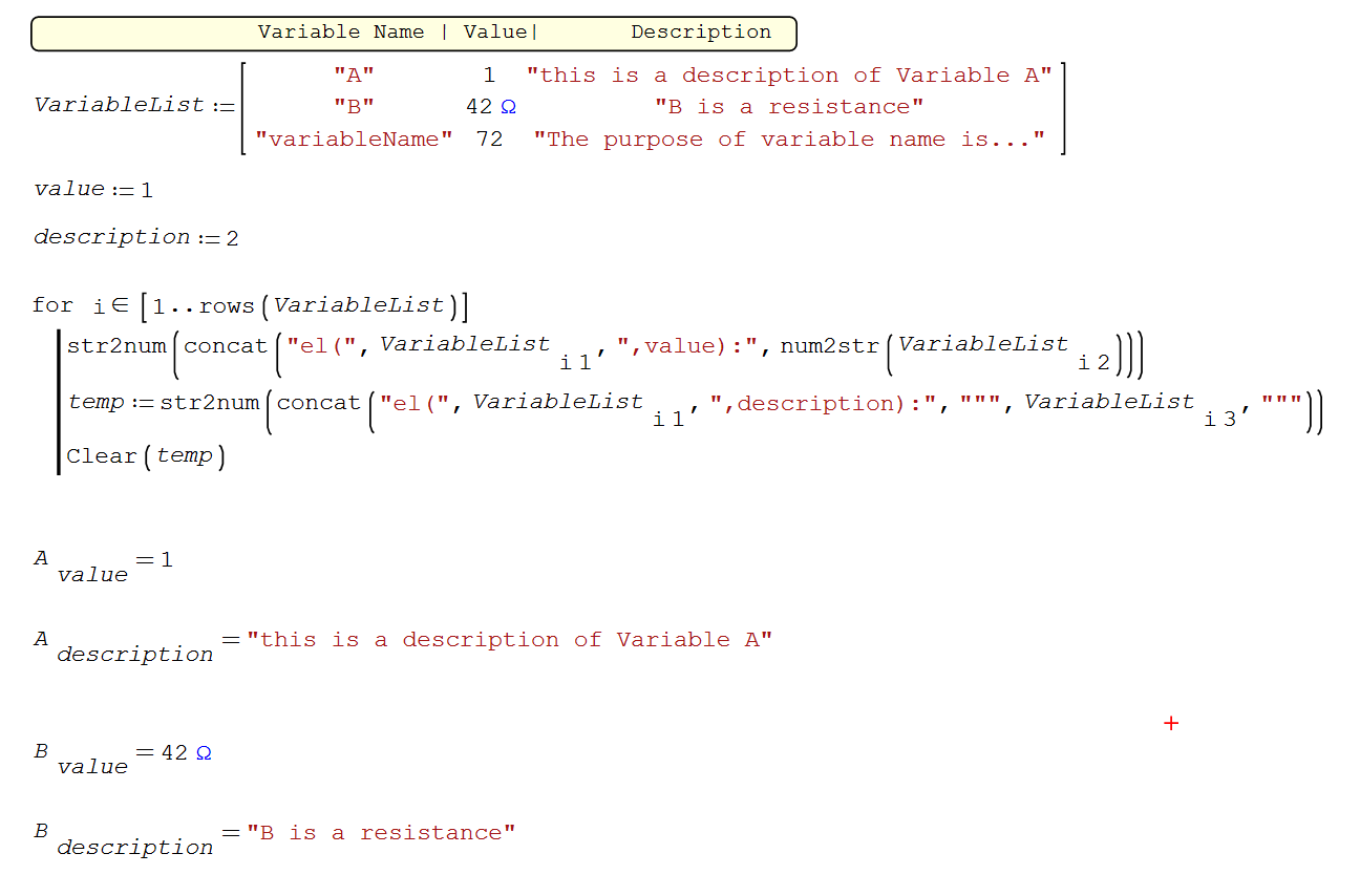

Aha! I figured it out
I'm pretty happy with this solution.
Here's my updated file for a reference:
⚜ Kenny Lemens, P.E. ᵂᴵ 2022/10/26 11:32:00, Alvaro 2022/10/26 14:29:00
