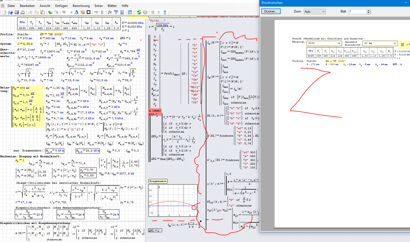

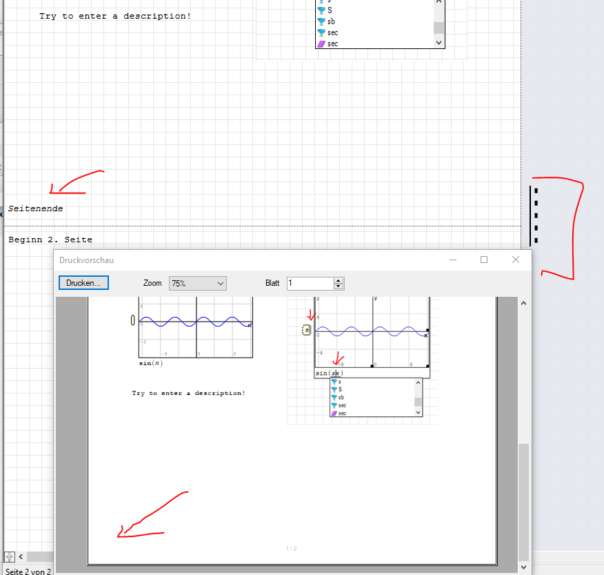

The red marked block is so long, that it reaches the top of following page.
As you can see in the preview window, the sheet content is not printed.
Page 2 starts after the page brake with "Biegedrillknicken" when "Printing Bounds" is used.
While using "Pages view", the first printed page looks the same (mostly white) but the second page starts with the skipped content "System l=5,00m..."
Setting the font size only of the large block to something smaller so the bottom of it doesn't reach the page brake solves this issue.

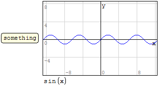

WroteFound another issue, while editing the description of a 2D plot:

WroteDiscovered following behaviour concerning page brakes with very long blocks:
Maybe the problem is the construction ?
Document would surely help volunteers.
WroteWroteFound another issue, while editing the description of a 2D plot:
Not clear w/o the document.
WroteWroteDiscovered following behaviour concerning page brakes with very long blocks:
Here you are:
Pagebrake.sm (70.7 KiB) downloaded 1081 time(s).

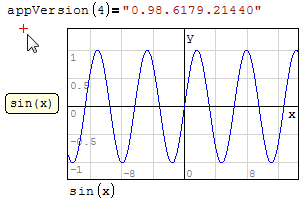

sin(x0 something => no problem Smath 6179

WroteWroteHere you are:
The long page brakes are not in the attachment !
Sure they are (I uploaded a simplified example):
When you put the cursor in the description and edit the text, a matching variable in the input data is edited simultaneously.
Screenshot: description is edited -
Your screen shot is explicit enough, but the document would help
more collab to check that particular issue or similar problem.
Nobody reported this bug, if it is an Smath bug.
WroteWroteFound another issue, while editing the description of a 2D plot: ...
The document is linked in post #7. And the screen capture in post #9.

Can repeat both bugs with the provided file on 6654. Oddly enough I was able to enter a description sometimes without effecting the data field if I first clicked within the data field, then immediately clicked the description field. This only worked occasionally and seemed dependent on where I clicked within the data field.
WroteCan repeat both bugs with the provided file on 6654. Oddly enough I was able to enter a description sometimes without effecting the data field if I first clicked within the data field, then immediately clicked the description field. This only worked occasionally and seemed dependent on where I clicked within the data field.
Bug/NObug ... pretty strange, whatever.

Quick tip to get rid of "sometimes without effecting the data field"
1. in the description, type few letters not common to data field
2. once finished the description, zap the fake letters.

To avoid "shadow in the context" I uploaded a very clean sheet (#7) which shows exactly the behaviour I described.

Thank you! Both issues are reproduced and will be fixed asap.

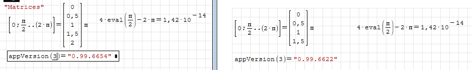

WroteWroteAre you doing something wrong or bug wrt your Smath version?
My sheet has the app version. I'm on 0.99.6654. Looks like that may be the problem
https://en.smath.info/forum/yaf_postsm47682_X-Y-Plot-Region.aspx#post47680
Jean confirmed similar issue with Maxima plugin too https://en.smath.info/forum/yaf_postsm47682_X-Y-Plot-Region.aspx#post47682
