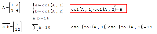

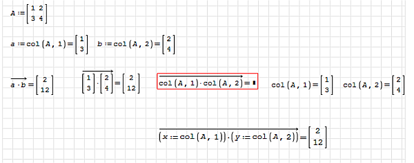

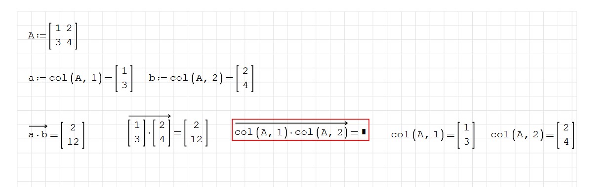

I am having this issue evaluating the vectorized multiplication:
I don't know what the problem could be. I started today switching definitely from Mathcad Prime 5 and started rewriting some codes.
Really happy with the decision I made, and also with the latest SMath studio version, I am running 0.99.7251 SMath.
Thank you in advance for your help,
Alvaro Gavilán
Vectorize.sm (6.15 KiB) downloaded 1330 time(s).
#2 Posted: 2020/4/16 02:37:32
Fridel Selitsky
Fridel Selitsky
520 likes in 451 posts.
Matrices are multiplied like in a matcade
#3 Posted: 2020/4/16 11:23:24
Just a matter of isolating the code
col(A,1), col(A,2) are not like function.
#4 Posted: 2020/4/16 15:52:44
NDTM Amarasekera
NDTM Amarasekera
130 likes in 352 posts.
This way it works.

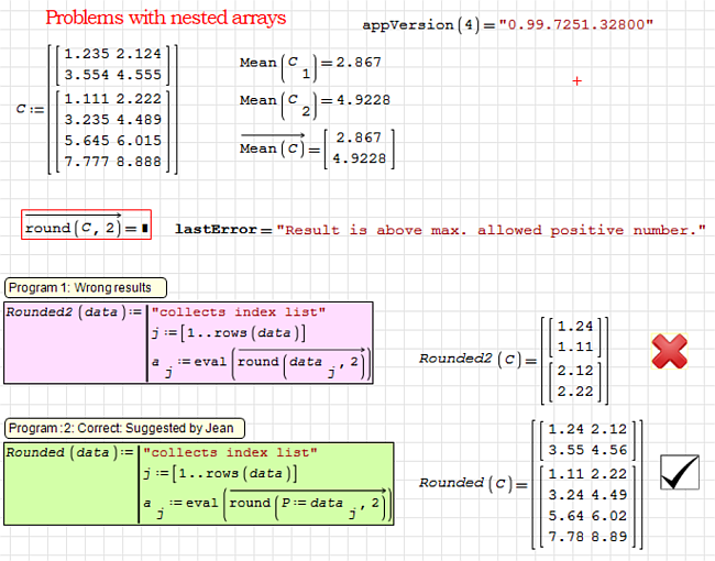

#5 Posted: 2020/4/16 16:44:34
NDTM Amarasekera
NDTM Amarasekera
There are some more issues with the vectorize function
#6 Posted: 2020/4/16 20:57:28
Alvaro Gavilán
Alvaro Gavilán
26 likes in 68 posts.
Thank you all for your quick responses! Problem solved with ndtma solution. Thank you

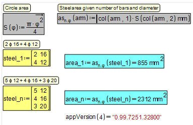

#10 Posted: 2020/4/24 22:45:36
Alvaro Gavilán
Alvaro Gavilán
Thank you Jean for your suggestion.
I would rather use a function, because in various parts of my worksheet (beam design), I need that function. It would be like this:
AG24042020-Steel area.sm (6.48 KiB) downloaded 1302 time(s).
#11 Posted: 2020/4/25 16:45:24
Maybe like this.
Project SteelBar.sm (23.19 KiB) downloaded 1342 time(s).

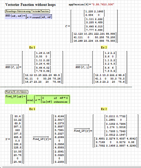

#12 Posted: 2020/11/8 09:58:14
NDTM Amarasekera
NDTM Amarasekera
Vectorize function without loops.
Vectorize_Eady.sm (15.01 KiB) downloaded 1270 time(s).
