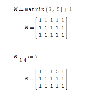

#3 Posted: 2021/9/28 08:37:33
1,443 likes in 2,935 posts.

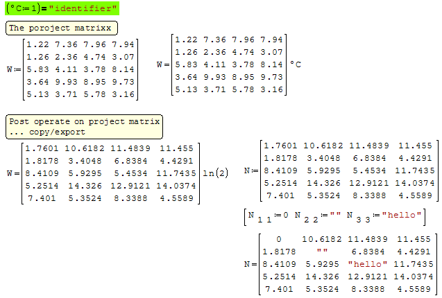

#4 Posted: 2021/9/28 09:17:41
... observe the empty place holder is a / operator.

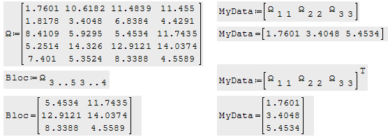

#6 Posted: 2021/9/28 11:15:31
Thank You Jean, but rather, I meant to extract a specific element from the matrix.
There are many more ways ... like skinning a cat.
Cheers ... Jean.
#7 Posted: 2021/9/28 13:28:22
Thank You Jean, but rather, I meant to extract a specific element from the matrix. Sorry but my English is very poor.
Adam
You can press [ when a variable is selected to write in the worksheet a "vector element" placeholder to access an element of a vector/matrix.
Indices are "base 1", therefore any value from 1 to the number of elements is accepted.
A single placeholder in matrices reads the values by linear indexing that is reading each element of a row before going to the next one).
You can add a second placeholder for accessing rows and columns coordinates by typing an argument separator (usually a comma or a semicolon) when the first placeholder is selected.
[ is a shortcut for the function el(1), so it is possible to create the same thing with the following sequence
write el
press TAB KEY
write matrix name
press RIGHT ARROW KEY
write 1st index number or name
[optional]
press ARGUMENT SEPARATOR KEY
write 2nd index number or name

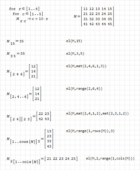

#8 Posted: 2021/9/28 16:21:01
1,123 likes in 1,795 posts.
Hi. There are many different ways to access the elements of an array. This list is not exhaustive, and does not include the submatrix function.
M.sm (10.01 KiB) downloaded 1063 time(s).
