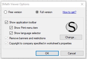

Main change of this version is that some features of the program will work only for those who signed in using smath.com credentials:
File not found. > File not found.
F.e.:
  • [DONE]Full version of SMath Viewer;
  • [IN PROGRESS]Open worksheets from SMath Studio in the Cloud directly in Desktop version (with possibility to save back to the Cloud);
  • [IN PROGRESS]Automatic back up of the worksheets to the Cloud (when turned on);
  • [IN PROGRESS]Reporting observations directly from SMath Studio;
  • [IN PROGRESS]Worksheet Author field automatically filled in with a name from Account for new Worksheets/Documents;
  • [IN PROGRESS]Synchronization of the program settings between devices (when turned on).
Full version of SMath Viewer is now available for signed in users:

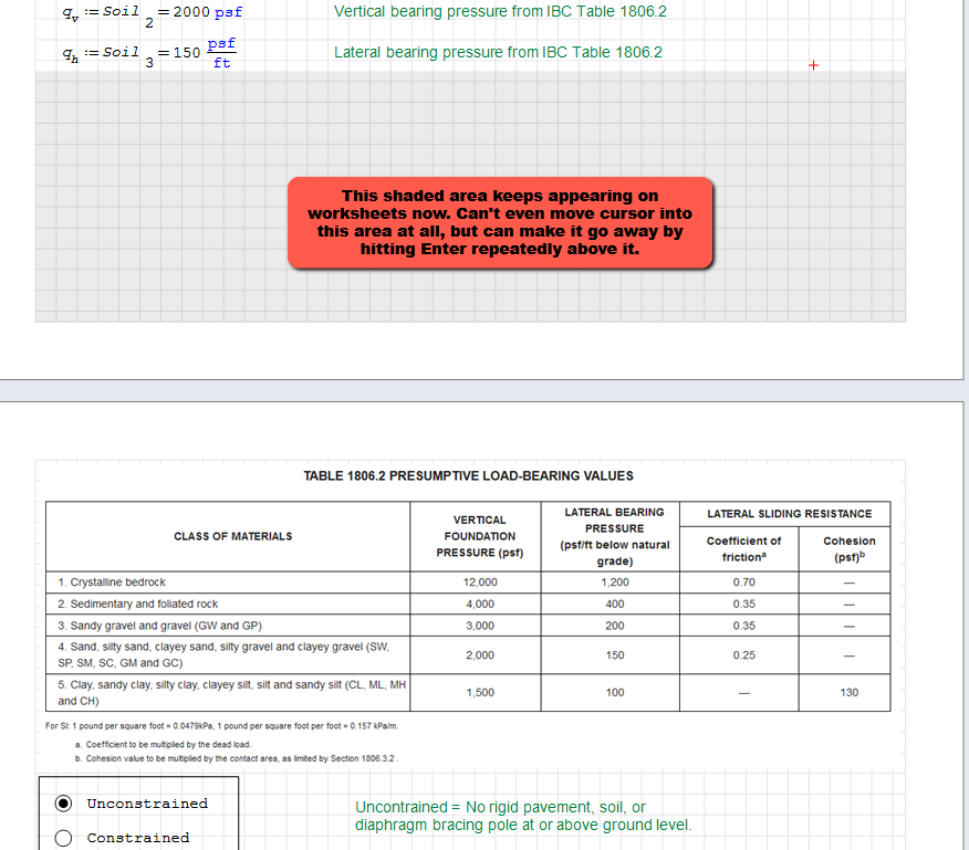

There's also another issue that started appearing in the previous build, but still occurs in this one. See below for a screenshot of the shaded region at the bottom of the page that is inaccessible. The cursor cannot be placed or moved into that area. Trying to move any text or math region into it just makes those items bounce out. Seems to occur when I've had a graphic on the page above that moved down until it no longer fit on the page and moved to the next page. Then it leaves this strange shaded area where the graphic used to be on the upper page. If I hit the carriage return on the keyboard, one line of the shaded region goes away. So if hit Enter a bunch of times, the region temporarily goes away, but comes back later with more editing. Any ideas?
Thanks,
Jason

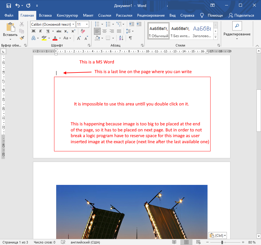

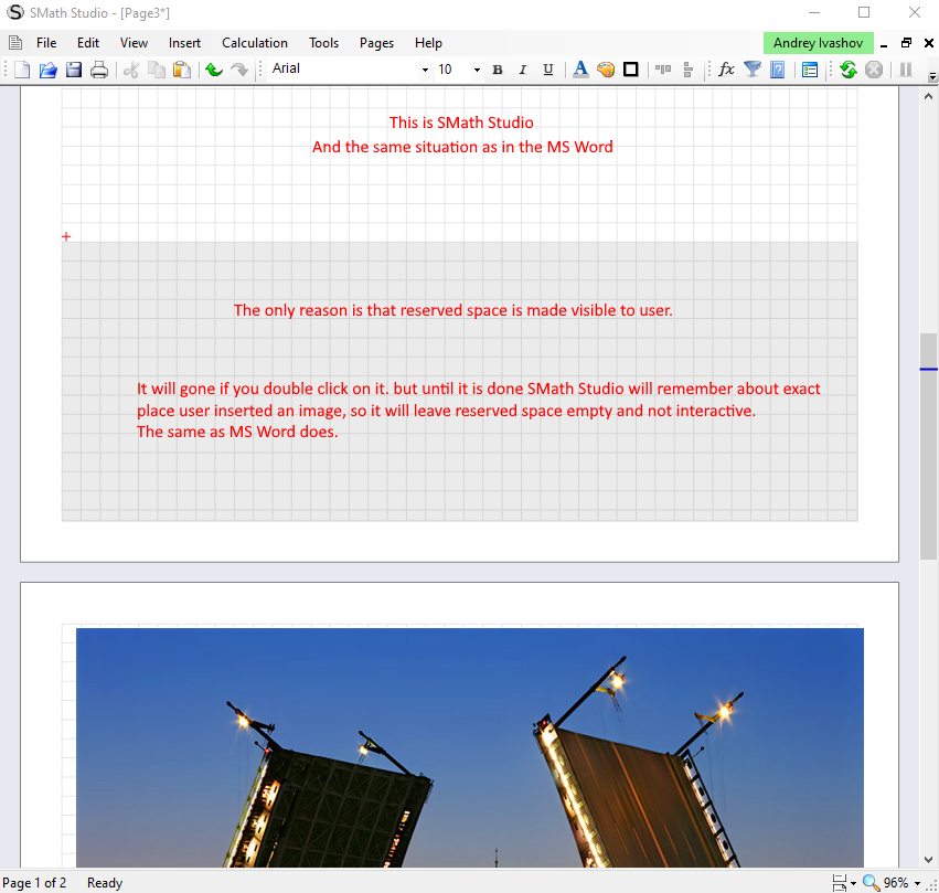

This is by design from the time when Pages representation mode was introduced. Please try to play with MS Word and SMath Studio side by side.

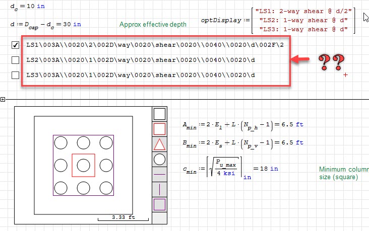

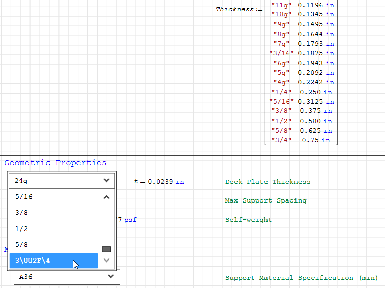

Any suggestions on how the text is displaying in controls?
The reason is in my comment here: https://en.smath.com/forum/yaf_postsm69253_IMAGE-REGION-DOESN-T-WORK.aspx#post69253
I will start correcting plugins today.
