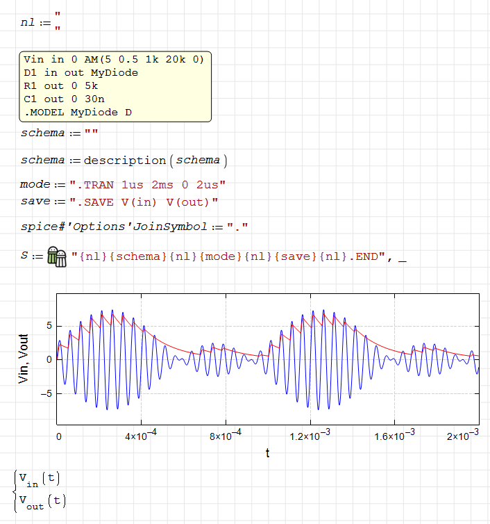

I haven't even tried these features myself yet. Support for all types of analysis hasn't been tested. There's still a lot of work to do. Maybe I'll do a direct insertion of values ​​into the circuit description. I wanted to try making a circuit with an amplitude detector. The authors have recently added the ability to specify an amplitude-modulated signal. They have a shell (GUI) in which you can also test circuits.

#14 Posted: 2025/9/12 10:09:29
1,554 likes in 1,864 posts.
SMath Studio compatibility History page Changes AI Assistant
Plugin updated. [BETA]
Changes:
- Refined Glyph Rendering;
- Added "spice#'Options'Interpolator" Operand.
Edited 2025/9/12 17:05:27

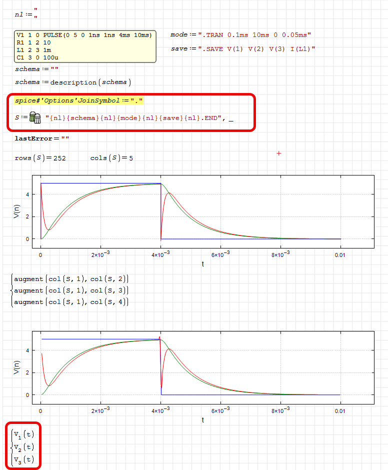

#15 Posted: 2025/9/12 11:10:39
It works
Alvaro 2025/9/12 18:01:36

Hi Viacheslav. Great work, congratulations. Some questions:
I was able to introduce an ampop, which is a fairly theoretical model without many physical parameters. How did you introduce the diode model?
Is it possible to import ltspice models more or less automatically?
Another question: how could V1, V2, and V3 be graphed in your 3DPlot plugin? The CreateSpace function is new, isn't it? Do you have examples of how to use it? Generally, these graphs can't be created in simulators, and the data must be exported to MATLAB or other similar software.
#17 Posted: 2025/9/12 19:20:54
Quote
I can tell you how to proceed, i.e. the algorithm for setting the problem.
If you want to simulate the scheme, then you need an example. Nowadays, in the programming world, it is common to accompany source texts with tests. These tests, as a rule, cover many typical tasks.
You need to find these texts, see the link below. Then introduce Gemini to the matter so that he can help create an adequate syntax. I simply throw the test sources into the chat as an example and say what I need.
Quote
Show me an example, if I do this, then yes, it can be done almost automatically and I will tell you how.
Quote
Not at the moment, but I can make it so that it will be possible. I don't have enough time to finish this plugin, as it is a bit more complicated than X-Y Plot.
Yes, CreateSpace() is a new function, I asked Gemini to make it, but I haven't used it yet. The plugin does not support the data format returned by this function.

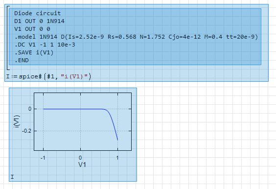

#18 Posted: 2025/9/12 19:56:21
1,123 likes in 1,795 posts.
Hi Viacheslav. Thanks, the link you provide shows how to simulate components, for example, a diode:
One more question: An option to have outputs with units? I think it would just be a matter of identifying time, volts, and amperes. It would be very practical to be able to use milli, micro, and nano prefixes.
