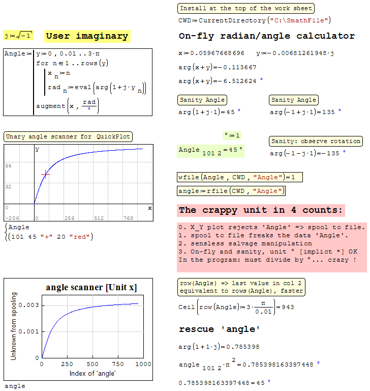

This the 'PJ" version [PJ = Pyjama]
1. Define imaginary user style 'j'
2. Don't re-use 'j' as index.
3. No need to spool to file, but X_Y plot
does not take unit ° in "Angle" [Not defined].
I have removed previous posting and work sheets.
Cheers, Jean
Angle Data 'j'.sm (9.59 KiB) downloaded 1122 time(s).

... just watch the unit system in your Engineering projects.
Angle Data 'j'.sm (16.53 KiB) downloaded 1075 time(s).
