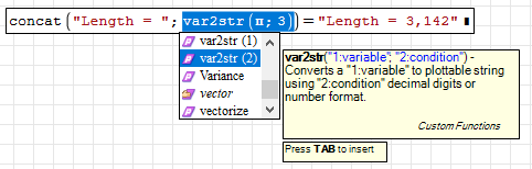

Hi, is there a way to show the output 51/500 in decimal form after concat("Length = ", num2str(L))?
#2 Posted: 2024/2/2 19:54:41
1,308 likes in 2,221 posts.
Yes.

Thanks so much for your help, mkraska!
