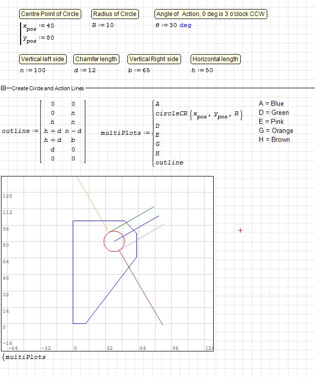

Hi All,
Trying to work out a universal way of getting the length of intersecting lines, easy when lines are level, but not so (for me) others.
The image below shows a lifting lug, the angle of action can be 0 deg to 150 deg for example. I need to know the length of the lines from the red circle to the outline, individually, then I can see the shortest length, this must be for all angles, effectively tracing the intersection point through the angles. I know I can use Pythagoras, but was hoping to use something like GPC, but this works only for polygons?

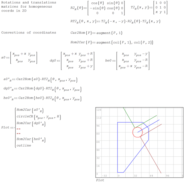

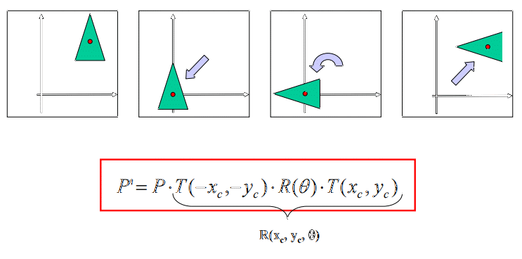

ianlh, in your example it’s convenient to use the rotation matrix
Lug Horizontal1.sm (18.13 KiB) downloaded 1007 time(s).

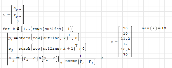

#7 Posted: 2020/7/20 13:46:20
1,355 likes in 2,271 posts.
This provides the shortest distance from the segments of the polygon to the circle. However, the distance isn't really to the segment but to a line through the endpoints of the segment. There is no test if the normal to the line through c is between the vertices of the segment.
For the given geometry this works. For proof of strength this is only useful if a given force may act under any angle but the force doesn't depend on that angle.
Lug Horizontal_Kr.sm (31.23 KiB) downloaded 992 time(s).

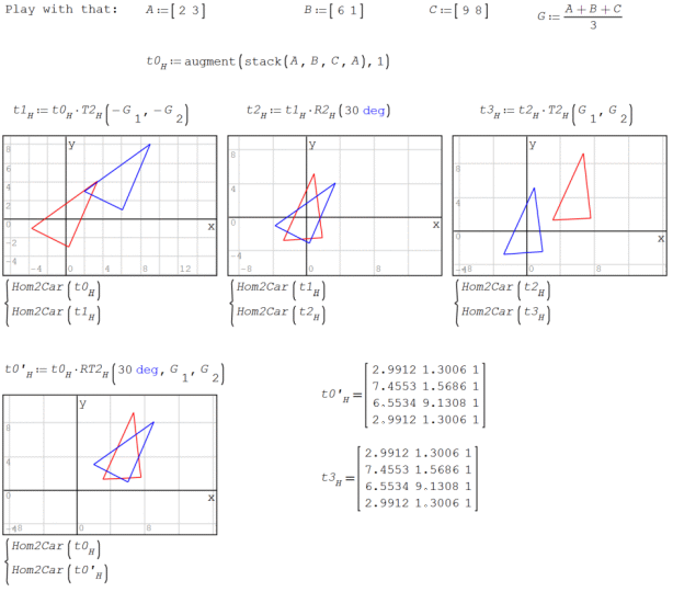

Hi. This is what's actually do the Ber'f function:
But notice that for use matrix multiplication for translations you must to use homogeneous coords ( http://elopez.fime.uanl.mx/@materias/732/@Tema%203%20-%20Transformaciones%202D.pdf page 15)
frapuano 2020/7/21 07:04:00, Fridel Selitsky 2020/7/21 04:23:00
#10 Posted: 2020/7/21 07:37:50
Fridel Selitsky
Fridel Selitsky
520 likes in 451 posts.
Thank you, Razonar.Aapplying homogeneous coordinates helps automate the process.
Variant with homogeneous coordinates
Lug Horizontal3.sm (17.83 KiB) downloaded 1032 time(s).

#11 Posted: 2020/7/21 14:15:57
1,123 likes in 1,795 posts.
Variant with homogeneous coordinates ...
Another variant.
Lug Horizontal4.sm (34.62 KiB) downloaded 1019 time(s).

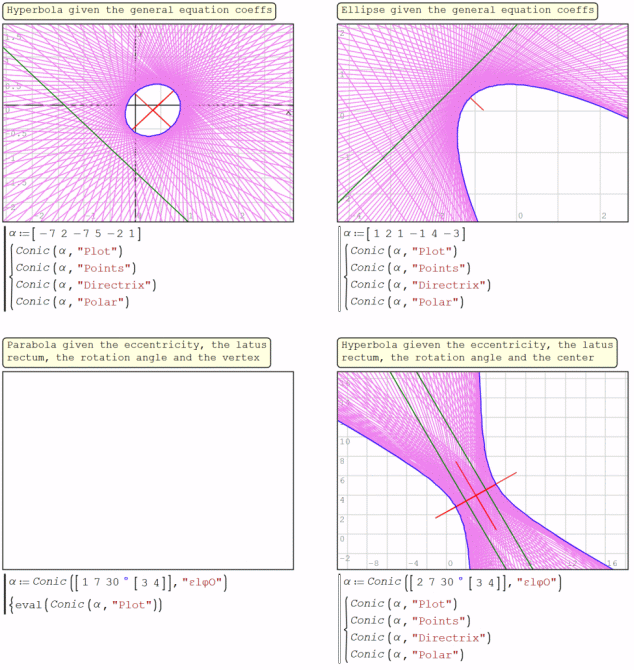

Homogeneous coordinates are helpful in projective geometry and conics and quadrics. For instance, preserve the duality, because you can use line coordinates ( https://en.wikipedia.org/wiki/Line_coordinates ).
I try to modify for use that in https://en.smath.com/forum/yaf_postst17357_Conics.aspx but can't found a close end. This is my atemp for the dual of a conic, it's envelope:
Fridel Selitsky 2020/7/21 15:25:00, frapuano 2020/7/22 08:29:00

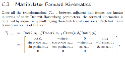

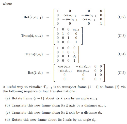

Hi Ber. That's not science, that's art. Maybe you can find this book interesting: Modern Robotics.
At page 608 in the pdf, for example:
The notation isn't the best, but it can be converted to a general Rotations and translations for the forward kinematics of a robot.
Fridel Selitsky 2020/7/27 04:49:00, sergio 2020/7/27 04:57:00
