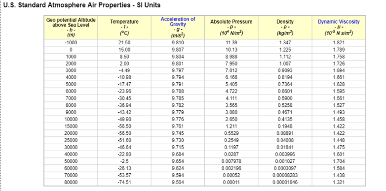

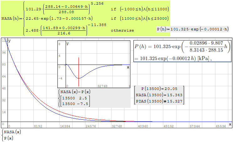

The NASA(h) is recent to me.
Curiously enough, they arrived at the same conclusion years ago:
Theodore, Jean, [Ralph ?] that altitude is not homogeneous
and represented by rational/expDecay/rational segments.
In this document, we just trust NASA as an act of faith !
To determine the altitude, kPa is the measured.
You may probably use the static from the Pitot tube or else
accurate barometric device... local barometric is headache.
Given as is if any useful for your journey in air.

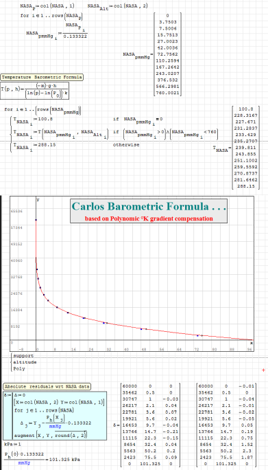

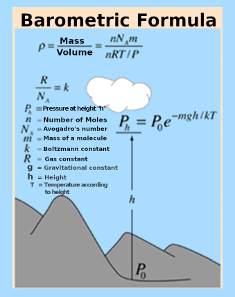

Hello Jean:
The atmospheric conditions are very changeable, so it could be said that
the data are only accurate at the time they are taken.
The density of the air changes with the temperature, and the
temperature changes with the altitude, then the barometric pressure also changes.
There is a barometric formula to calculate the air pressure according to the
altitude, to which I have included the temperature function according
to the altitude to try to make the calculation more accurate.
Barometrit_Formula_Aire_CBG.sm (423.21 KiB) downloaded 718 time(s).
Carlos

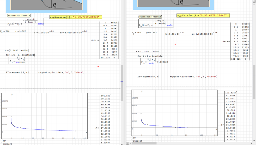

I do not know why SS6179 transforms the units differently to SS7089 and gives slightly different results.
Here you have the file in the SS6179 version.
Barometric_Formula_Air_6179.sm (423.31 KiB) downloaded 724 time(s).
Latest beta-versions of SMath Studio have huge improvements regarding accuracy, calculation performance and worksheet rendering performance. This is because currently I'm participating in a project where IAPWS equations is used and it was observed that all previous versions of SMath Studio had problems with accuracy. After reworking core of calculation engines it was observed that calculation speed became worse, so I have started work to improve performance in high accuracy calculations.
As for now SMath Studio became much more usable in both: accuracy and speed points of view (+ new rendering engine is here) and I'm doing latest preparations to release new stable build.

I have tried to calculate the temperature used or measured in the NASA data,
isolating the temperature variable from the barometric formula.
I hope you find a better approach
NASA_Invert_SS6179.sm (57.34 KiB) downloaded 701 time(s).
Thank you
Carlos

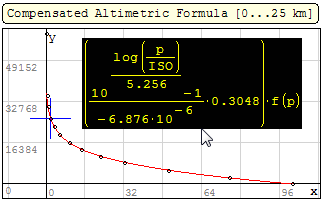

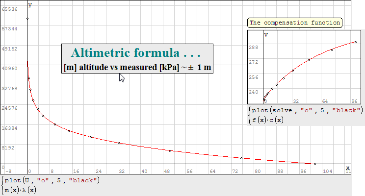

#10 Posted: 2019/6/12 23:41:04
... Here is Carlos . . . an un-ambiguous altimetric formula.
1. NASA solved for well distributed points
2. The inverse Barometric solved for the the compensation parameter.
3. Final altimetric at least up to 40 km
4. Accuracy depends upon NASA itself and kPa resolution
Will read your latest attachment ... Jean
Inst_ISA Altimetric Formula Copy.sm (32.91 KiB) downloaded 698 time(s).
#11 Posted: 2019/6/14 19:46:37
The Altimetric session ends here for quite a while unless more revelation.
Formula page 7/7 ... auto-compensated on actual/local ISO [101.325 kPa].
The mutual conformity wrt solved NASA(h) is stricking of realism.
Comments/suggestions ... welcome.
Inst_ISA Altimetric Formula Copy.sm (131.19 KiB) downloaded 685 time(s).

The Altimetric session still has a little more chapter, since the
Barometric Formula can be adjusted for the variable of gravity
Inst_ISA Altimetric Formula Gravity.sm (227.89 KiB) downloaded 760 time(s).
Carlos

#14 Posted: 2019/6/17 23:55:49
... last brick in the wall.
1. NASA(h) Barometric ... kPa given altitude (h)
4. Nasa(p) Altimetric ... altitude (h) given kPa
................sections [2, 3] not needed for publishing
though guide line for discrete solve.
Just need the dual formulas [image below]
Inst_ISA Barometric_Altimetric Companion.sm (91.43 KiB) downloaded 699 time(s).
