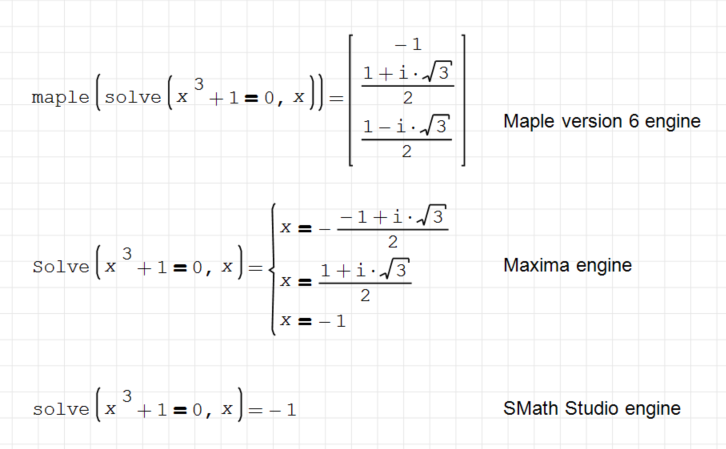

Is it not possible to use the latest version of Maple engine or at least a newer one?

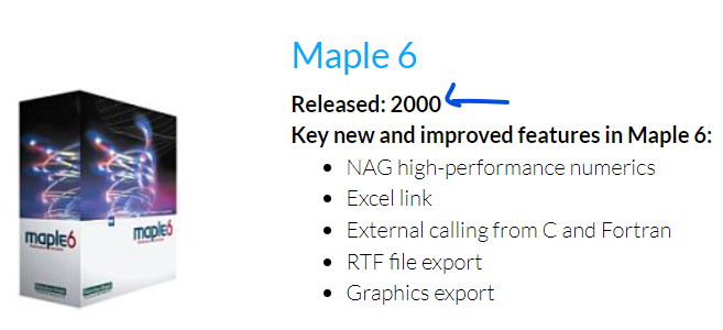

I see that currently version 6 of Maple (released in year 20000, so 24/25 years ago) is used:
I am wondering if is not possible to use a newer version of Maple engine in Smath?

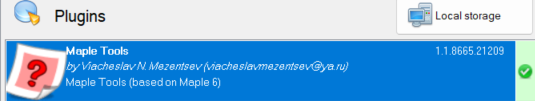

There are several reasons. Firstly, this Maple plugin is made by only one person and he does not have enough time to do anything extra. Secondly, old versions of Maple could be divided into console and window parts. The console part can be placed entirely in the plugin, so the function is immediately available after its installation. Thirdly, the syntax and capabilities of the maple engine change and it takes a lot of time to debug the interaction of the two programs.
Yes, theoretically it is quite possible to do this, but from the practical side it is inconvenient. Maxima plugin went this way, and started with the maple version.
Now inside the Maple plugin there is a license file, so you can use it, but someday it will end. Due to licensing issues, there is no desire to make any improvements, it is better to spend time on free software.

But Smath Studio without additional engines like maple engine or maxima or any other powerful math engine...Smath seems to have only numeric capabilities (probably these numeric calculation capabilities strong enough up to a certain point, right?), and When it comes to symbolic calculation then Smath Studio stuck, is lost, without working together with these additional engines. That's I asked what will happen when will not be aymore possible to use maple/maxima engine in Smath studio. Also, with the passage of time without improvements even to these engine used by Smath (maple, maxima, or Smath studio own engine), Smath will become weak, when the need for computing power/calculation will increase.

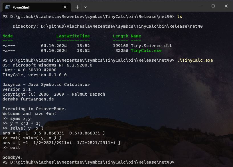

I have my own development for this case, if necessary, I can connect my own port for symbolic engine based on Jasymca.

Oh, so we see that SMath own engine is very week...though the problems was pure numeric...

As for your example, you have to be honest. SMath Studio writes in the documentation what this function does. It is neither good nor bad. It does its job.
