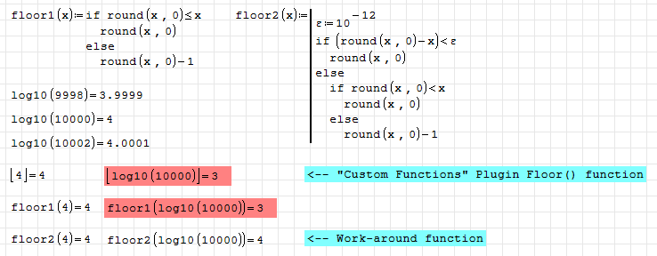

Let me explain what I am trying to accomplish. Maybe there is a better method.
For all numbers 100 to 999, I want the function to return "2"
For all numbers 1000 to 9999, I want the function to return "3"
And so forth.
Since log10(100)=2 and log10(999)<3
and log10(1000)=3 and log10(9999)<4
I thought that "floor(log10(n))" would work.
However, the implementations of floor that I tried, do not return the correct value for integer powers of 10^x. As shown in my example.
-Jeff
#4 Posted: 2016/11/2 19:50:50
1,443 likes in 2,935 posts.
I think I found another quirky behavior.
It is because SMath returns 3.9999999999 (set the region to display 15 decimal places)

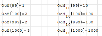

And so forth.
Until is not fixed you can try with OoM(...) (order of magnitude) from Custom Functions plugin.
