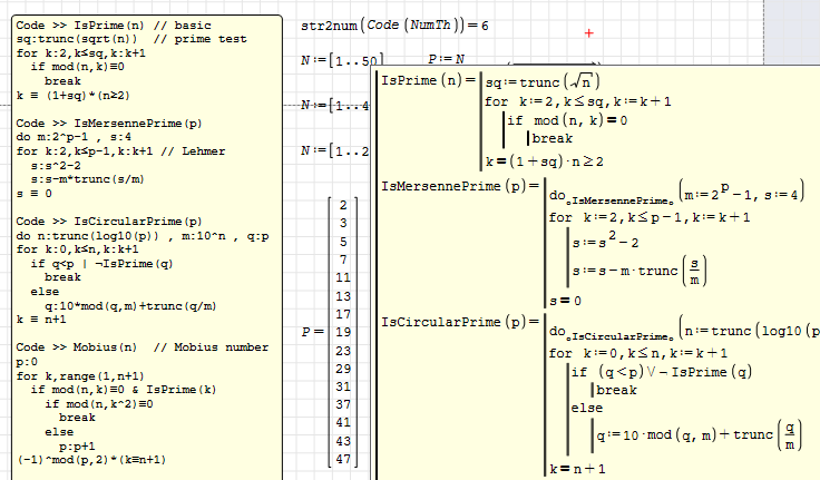

This function take the script in the variable description and try to convert it into a SMath function.
Code.sm (43.79 KiB) downloaded 1645 time(s).
Code.pdf (185.65 KiB) downloaded 988 time(s).

Updated for if(2), if(3) and if(4).
Code.sm (58.16 KiB) downloaded 1546 time(s).
Code.pdf (244.84 KiB) downloaded 948 time(s).

Updated. Some few new features added.
Code.pdf (606.82 KiB) downloaded 985 time(s).
Code.sm (111.07 KiB) downloaded 1569 time(s).
