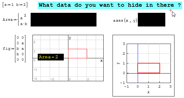

I try to do the sheet for calculate a specific engineering problem. So I have a few type of shapes. For example (trivial, of course) we have two figures: rectangle with 'a' and 'b' dimension, and square wchich has only one dimension 'a'. To calculate the area of the square we need only 'a' dimension. Then the area equals 'a^2'. We dont need 'b' and I want to hide this 'b' because I dont need it. But if my choice is to calculate rectangle area, the 'b' dimension have to be visible.
Is possible that a region inserted into the sheet can be expand or collapse dependind of choice? In such a region I would hide the data that is needed depending on the choice of the figure.

#11 Posted: 2019/7/18 10:55:10
is it possible to make visibility of formula or region false or true?
Answer is NO immediately by 1/0 logic ... Alternately
1. background black those math regions black is [1,1,1]
2. create a black image, capture with Wingrab [freeware]
... select/crop the black region in Wingrab
... paste that black image in Smath
... now in Smath you can re-paste as many as wanted
... slide the black over the regions
... by the handles you size the black master as desired
Another approach is to put the math regions in a Formatted Label
black the all maths in Formatted Label all at once
as well, if those regions aren't use: disable Formatted Label.
Borrowing bits and pieces from here and there that makes a soup project.
A project that is not stand alone will not pass Quality Control.
Page18.sm (9.41 KiB) downloaded 1164 time(s).
