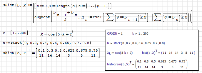

Hi Valery. This function returns the same result as mathcad.
sHist.sm (15.24 KiB) downloaded 824 time(s).

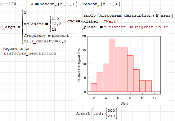

Maxima has a histogram plot function.
Taken from DOI: 10.25933/opus4-2949. The PDF has attached SMath documents.

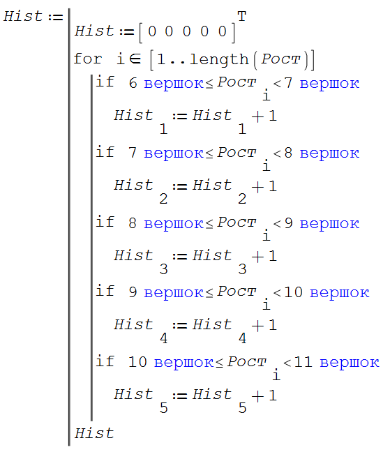

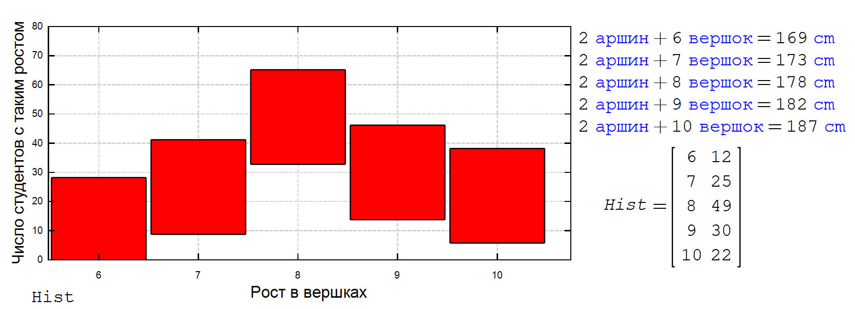

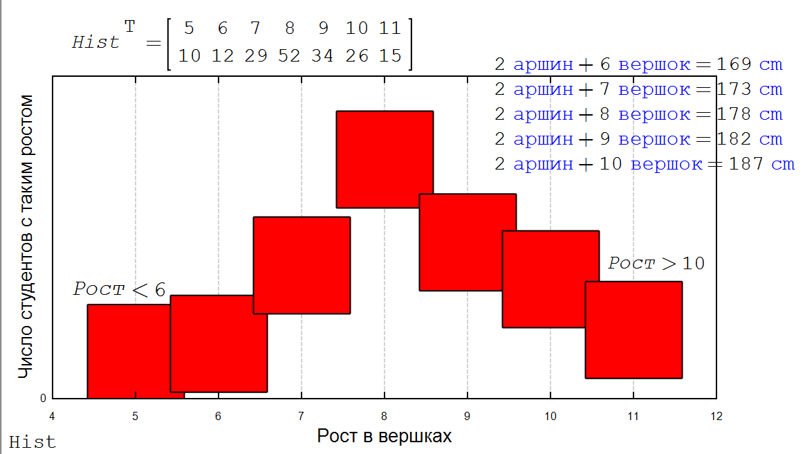

WroteMy students histogram
Are you looking for something more ;like this?
Valery Ochkov 2023/10/11 20:23:00

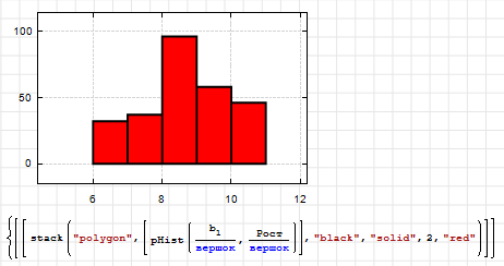

Hi. This version also works with unequally spaced bins.
pHist Mister-Class.sm (61.58 KiB) downloaded 817 time(s).
