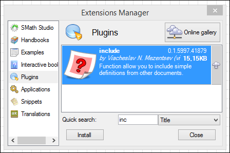

Please, never put/edit/remove any files from c:\Program Files (x86)\SMath Stdio\.
Use Tools > Plugins from SMath Studio main menu, switch to Online gallery and install plug-in:
P.S.: Do not forget to revert changes from c:\Program Files (x86)\SMath Stdio\plugins\.

Smath 5346 [April 2014] can fetch modules from other work sheets by the function
menu f(x) include(,) as demonstrated in the two attached. IMHO, I would discourage
starting with this idea. This approach is not professional as you will soon end
with quite a micmac of Smath documents. Smath is like Mathcad: it gets his power
from lot of user built modules.
