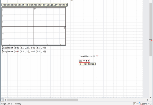

CBG
CBG
78 likes in 312 posts.
By--> Razonar
Quote
Hola Carlos. Try the following, a short version, just for n=2
By--> Ber7
Quote
Try also the old version of the Dragilev method
DragilevMet3.sm (24kb) downloaded 10 time(s)
Hola Alvaro, Hello Ber7,
Thanks for your reply, but the DragilevMet2 and 3 files do not work.
The file of Ber 7 does not show any error, but by requiring the value
of B1 and B2, it says that "x" is not defined.
Attached drawing of the errors.
Hello Jean, your files worked perfectly.
Carlos

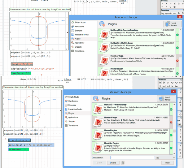

#14 Posted: 2018/2/23 15:56:57
CBG
CBG
Hola Alvaro:
Gracias por tu respuesta.
Thanks for your answer, but I found the fault.
The interference is caused by the Maxima Plugin,
by disabling it, the file works correctly.
Carlos
