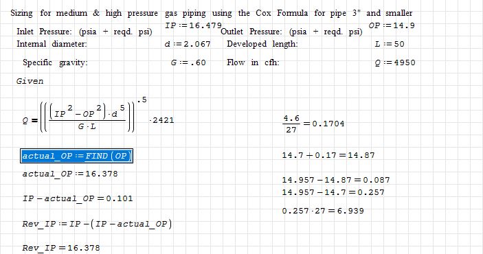

The Mathcad function I am looking to for in Smath is "Find"
Find = Returns the values of var1, var2, ...., that solve a system of equations in a solve block. returns a scalar if there is only one argument, otherwise returns a vector of answers.

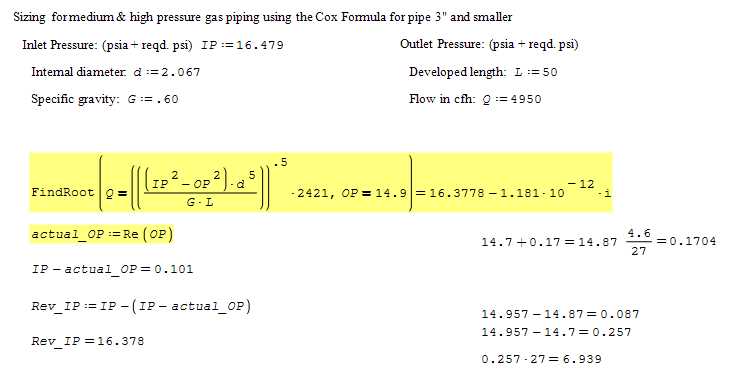

attached is a screenshot of the High pressure formula. i do not believe this is proprietary to mathcad. it is just a formula based on building codes for construction.

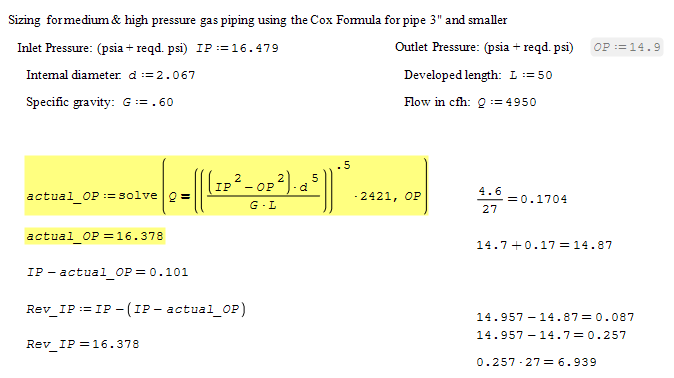

Your problem seems to be quite simple and mentioned here on the Forum many times (maybe to many...).
Using solve()
GASHP-cor.sm (9.94 KiB) downloaded 989 time(s).
Using FindRoot() from Numerical Solvers plugin
GASHP-cor1.sm (10.16 KiB) downloaded 1000 time(s).
