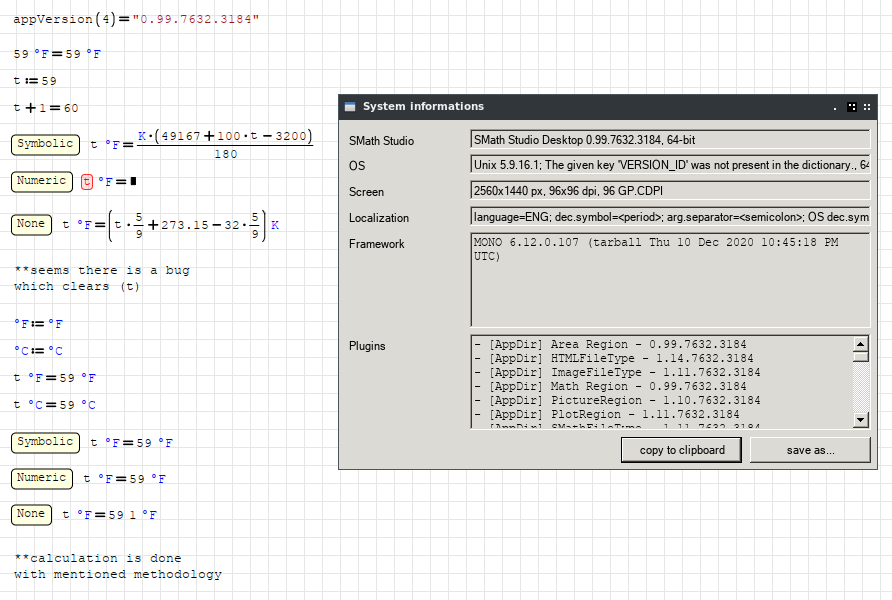

Hi. It seems that Fahrenheit degrees clears t.
Can anyone confirm this? I’m using the Mono version of release 7610 on Linux.
Yep. On Windows 10.

Thanks very much for looking at that Alvaro. I had only tried numeric evaluation- I get the same result as you with symbolic evaluation.
It looks like you are in even worse shape than I am. The variable is still set to the original value for me after attempting to get a Fahrenheit value from it.
