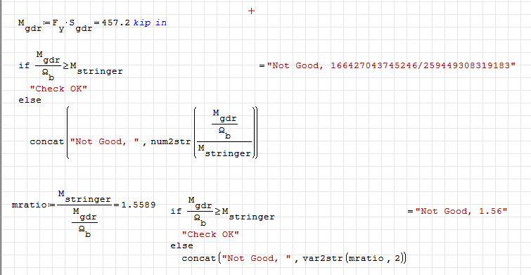

Here is an example of one application- I am checking historic building members, and if they are overstressed, I want to know by how much.
using num2str, I get a fraction as a result.
if I create a variable, then using var2srt(2) I can control the output format. I would prefer to not have to define the variable, but its workable.
so the conclusion i am getting is the error is in the argument, not the if/then function. here I am using the custom functions with max function
Thanks again
Dennis
