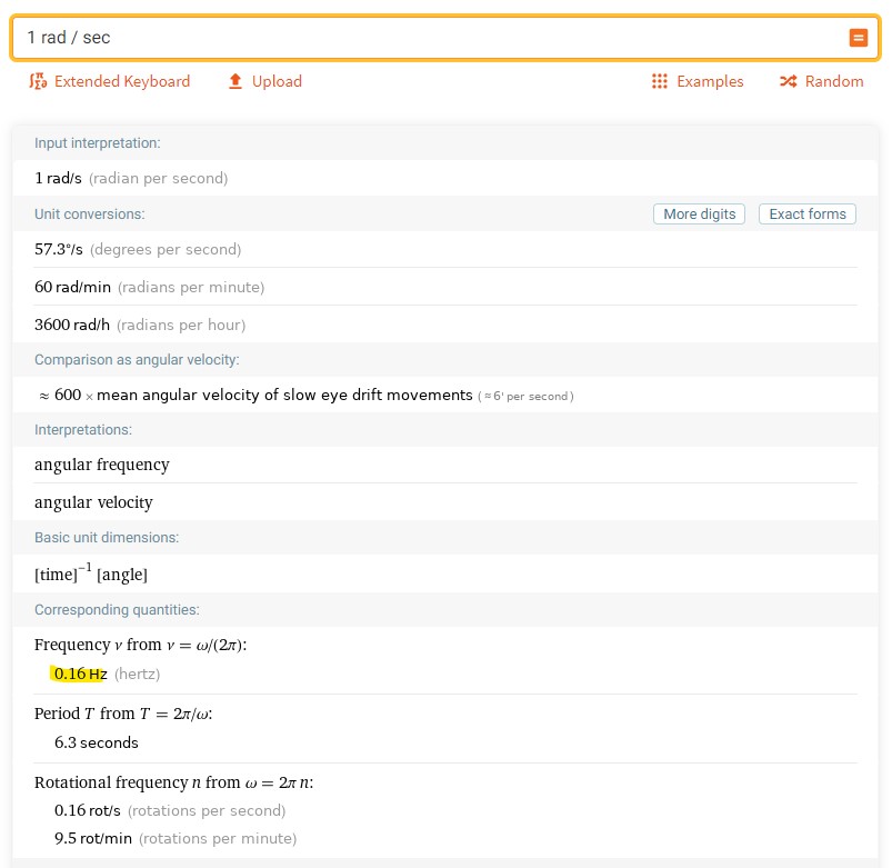

- https://www.wolframalpha.com/input/?i=1+rad+%2F+sec

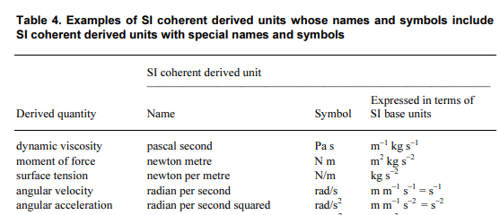

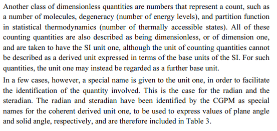

Nope. radian per second it is 1/s. In can't derive that from the animation, check the Official standard, from https://www.bipm.org/utils/common/pdf/si_brochure_8_en.pdf
Pages 119 - 120

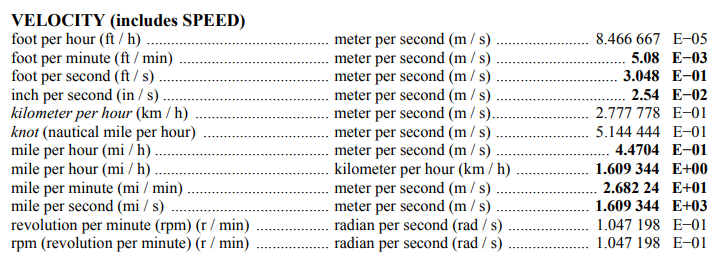

Thus, SMath it's correct. Maybe what your friend needs to use is rpm, which have also a correct definition in SMath. It isn't in the BIPM bureau but can find it at NIST: https://physics.nist.gov/cuu/pdf/sp811.pdf
Pages 119 - 120

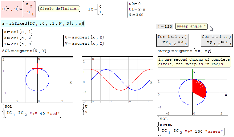

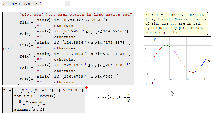

1rad/s reflects the speed of a flat angular motion [circular/elliptical motion]
More confusing is the numerical approximation of sin(x), cos(x) ...
The argument 'x' is rad.
The visitors may complete the X_Y plot attached.
Maths sin(deg) plot.sm (17.61 KiB) downloaded 1067 time(s).

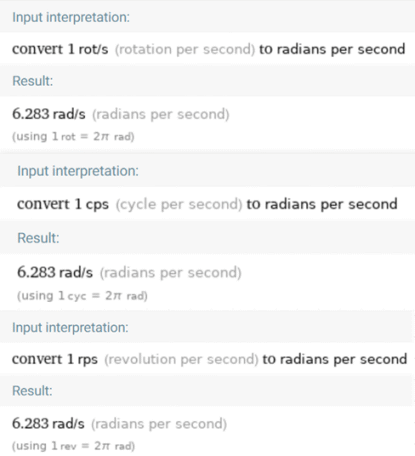

Hi. You can introduce definitions for cycle, rotation and revolution. In Wolfram alpha all are the same, but I think you might find this discussion interesting, where my choice for cycle is cycle:=1, not 2 Pi.
https://community.ptc.com/t5/PTC-Mathcad/Curve-fitting-units/m-p/499667
Naming rev or rot as 'rev:=2*Pi you can handle those values that appear in wolfram alpha.
From https://www.wolframalpha.com/input/?i=rot+%2Fs+in+rad%2Fs and similar:

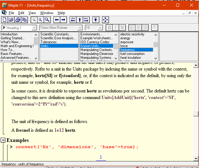

Finally, you can implement more complicate solutions, like this one in maple:
