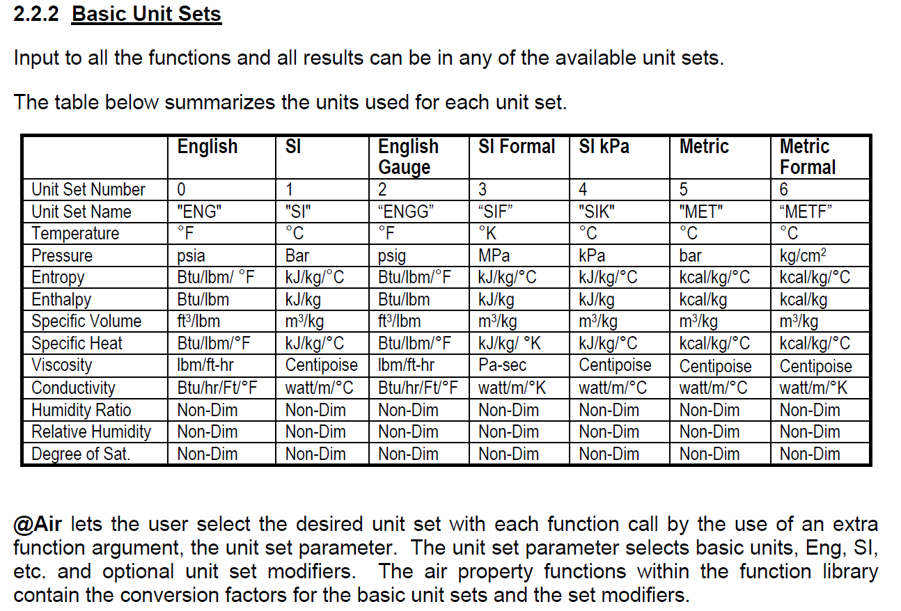

You must manually copy the Mcdair32.dll to the userefi folder (".../Application Data/.../91a20d24-c30b-4774-9b1b-4d502a80420f/x.x.x.x/userefi/" ) and TAir32.dll to the \windows\system32\.

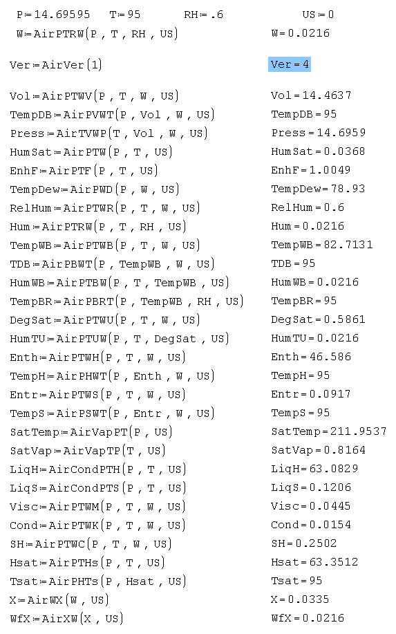

AirPTWV - [Mcdair32.dll] [ P, T, W, UnitSet ] returns the specific volume
AirPVWT - [Mcdair32.dll] [ P, V, W, UnitSet ] returns the dry bulb temperature
AirTVWP - [Mcdair32.dll] [ T, V, W, UnitSet ] returns the pressure
AirPTW - [Mcdair32.dll] [ P, T, UnitSet ] returns the saturated humidity ratio
AirPTF - [Mcdair32.dll] [ P, T, UnitSet ] returns the enhancement factor
AirPWD - [Mcdair32.dll] [ P, W, UnitSet ] returns the dew point temperature
AirPTRW - [Mcdair32.dll] [ P, T, R, UnitSet ] returns the humidity ratio
AirPTWR - [Mcdair32.dll] [ P, T, W, UnitSet ] returns the relative humidity
AirPTWB - [Mcdair32.dll] [ P, T, W, UnitSet ] returns the wet bulb temperature
AirPTBW - [Mcdair32.dll] [ P, T, B, UnitSet ] returns the humidity ratio
AirPBWT - [Mcdair32.dll] [ P, B, W, UnitSet ] returns the dry bulb temperature
AirPBRT - [Mcdair32.dll] [ P, B, R, UnitSet ] returns the dry bulb temperature
AirPTWU - [Mcdair32.dll] [ P, T, W, UnitSet ] returns the degree of saturation
AirPTUW - [Mcdair32.dll] [ P, T, U, UnitSet ] returns the humidity ratio
AirPTWH - [Mcdair32.dll] [ P, T, W, UnitSet ] returns the specific enthalpy
AirPWHT - [Mcdair32.dll] [ P, W, H, UnitSet ] returns the dry bulb temperature
AirPHWT - [Mcdair32.dll] [ P, H, W, UnitSet ] returns the dry bulb temperature
AirPTWS - [Mcdair32.dll] [ P, T, W, UnitSet ] returns the specific entropy
AirPWST - [Mcdair32.dll] [ P, W, S, UnitSet ] returns the dry bulb temperature
AirPSWT - [Mcdair32.dll] [ P, S, W, UnitSet ] returns the dry bulb temperature
AirVapPT - [Mcdair32.dll] [ P, UnitSet ] returns the water vapor saturation temperature consistent with UnitSet
AirVapTP - [Mcdair32.dll] [ T, UnitSet ] returns the water vapor saturation pressure consistent with UnitSet
AirCondPTH - [Mcdair32.dll] [ P, T, UnitSet ] returns the liquid water specific enthalpy consistent with UnitSet
AirCondPTS - [Mcdair32.dll] [ P, T, UnitSet ] returns the liquid water specific entropy consistent with UnitSet
AirPTWM - [Mcdair32.dll] [ P, T, W, UnitSet ] returns the dynamic viscosity
AirPTWK - [Mcdair32.dll] [ P, T, W, UnitSet ] returns the thermal conductivity
AirPTWC - [Mcdair32.dll] [ P, T, W, UnitSet ] returns the specific heat
AirPTHs - [Mcdair32.dll] [ P, T, UnitSet ] returns the saturated specific enthalpy consistent with UnitSet
AirPHTs - [Mcdair32.dll] [ P, H, UnitSet ] returns the saturated temperature consistent with UnitSet
AirWX - [Mcdair32.dll] [ Humidity Ratio, UnitSet ] returns the mole of mass fraction consistent with UnitSet
AirXW - [Mcdair32.dll] [ mole or mass fraction, UnitSet ] returns the humidity ratio consistent with UnitSet
AirVer - [Mcdair32.dll] [ dummy ] returns the @Air version and serial number
