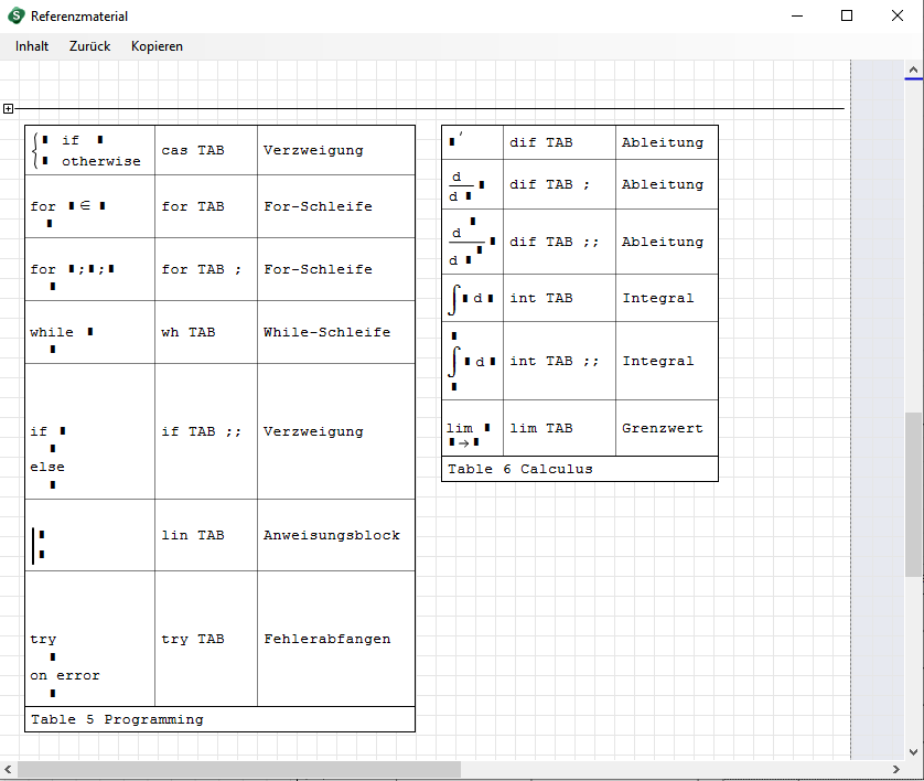

#7 Posted: 2022/4/11 06:51:49
1,355 likes in 2,271 posts.
In Appendix B of the SMath Handbuch you find a list of operators and how to input them.
There is also a snippet "Help" in the online gallery but some entries there are not correctly formatted (problem with Table region).
In the interactive handbook you find these tables under >SMath Studio Documents >Operators and their keyboard input.
The tables there seem to be ok. There seem to be differences between the rendering engine in the reference material window and in the main window of SMath Studio.
