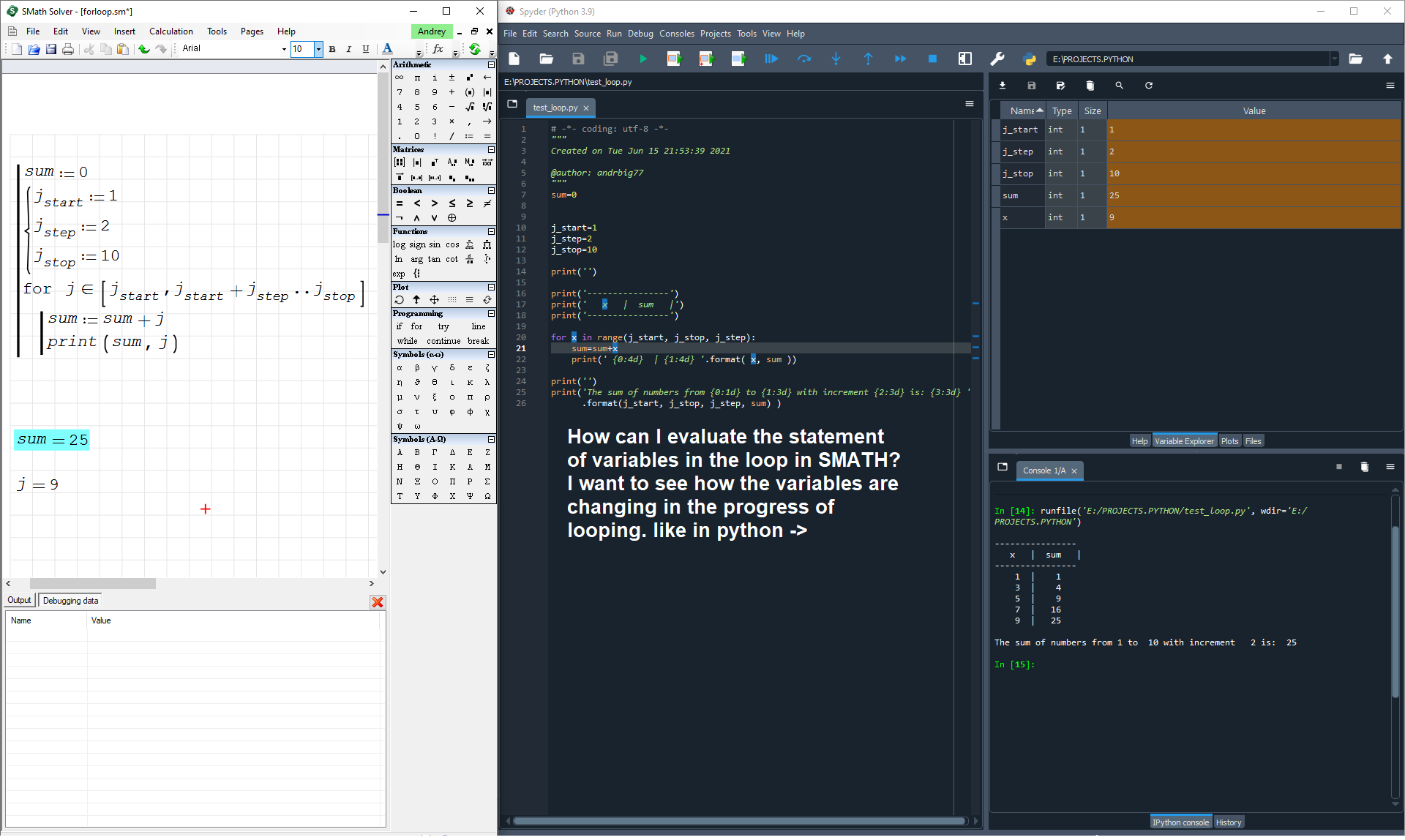

Dear Smath-experts,
How can I evaluate the variables in the loop in SMATH?
I want to see how the variables are changing in the loop like in python.
Is what debug is for, but how does it work?
Best regards,
Andrey

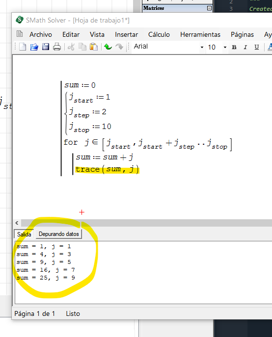

Hi Andrey, you can use trace() for check how variables are changing in the loop:
Oscar

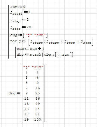

#8 Posted: 2021/9/11 10:37:47
580 likes in 1,348 posts.
trace() or breakpoints are usually de-facto way to go.
Alternatively you can store variables to a matrix.
