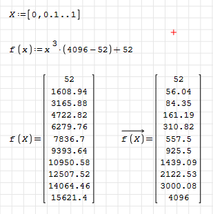

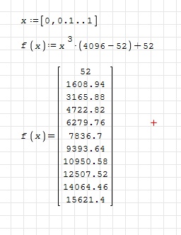

Hi, Is there a reason why I'm getting those obviously wrong results?
#2 Posted: 2023/9/28 12:35:00
1,078 likes in 1,749 posts.
Hi. Looks like a bug in the "implicit scalar expansion" according to the expression in matlab for vectorization. Use explicit SMath's vectorize as workaround.
#3 Posted: 2023/9/28 13:50:33
S0lo
S0lo
0 likes in 11 posts.
Thank you very much. At least there is a work around!

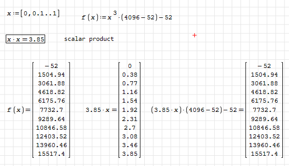

#4 Posted: 2023/9/28 19:59:28
Hi. Looks like a bug ...
Or not. It depends on how x^3 is interpreted. If the usual recursive definition is used, x^3 = (x^2)*x, then x^2 = x*x would be a dot product, while x^3 = (x*x) *x would be the product of a scalar times a vector, and the SMath result would be correct, although perhaps not the 'expected' one.
