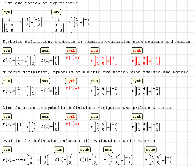

I just wanted to get into attention this thread once more. There were problems of rather different results using different optimization and different solvers. Those problems still remained unexplained.
Just look at the picture and try the attached file. Changing the symbolic/numeric/none optimization and using/not using eval() for the yellow regions, there will be different results. This time, we will get different results - sometimes scalars, sometimes vectors.
Primer63w_again.sm (36.71 KiB) downloaded 1327 time(s).
WroteThis is not good by all means. Something has to be done about it.
The reason for the problem is the type-unawareness of the symbolic optimization, as was already discussed in the Transpose function bug topic.
Thus, what can be done? When SMath does symbolic optimizations, certain assumptions are made (just like operators being scalar). Strictly taken, you would need to add a type checking instruction to any definition that is optimized under such assumptions. Alternatively you could block invalid optimizations by providing type information. Function arguments that are to assume matrix values would require to be marked as such. Otherwise matrix arguments are to be refused by the function.
I'd propose to use the ~ character including the boldface markup for matrix valued variables.

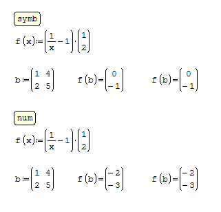

Currently, the ~ character is used for absolute variables. I never used this concept and have never seen any example from other users. If I remember correctly, Andrey announced this feature as essential for animations to work. However, this does not seem to require any user access to such variables. Thus I think that dedicating the math region capability to show boldface symbols to matrix and vector variables would be welcomed by most users.
Look at the attached image: Wouldn't that be nice? Boldfacing the function name would indicate that matrix values are expected to be returned. The boldface 1 would preferrable be interpreted as unit matrix of appropriate size. Alternatively, this could mean a matrix of all ones just like boldface zero would be a zero matrix. Unit matrix could be a boldface I.
