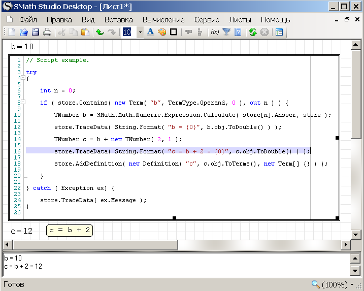

I think it will be available this summer.
Davide Carpi 2014/5/2 05:02:00, Radovan Omorjan 2014/5/2 06:33:00

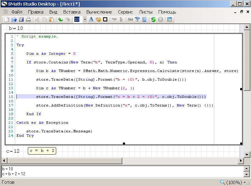

VB.Net script example.
