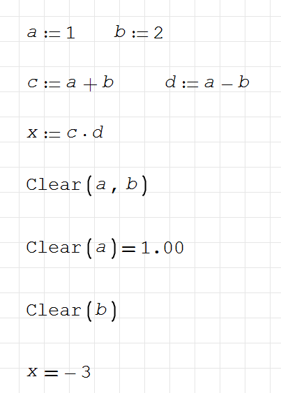

The only way is to define the variables after the expression, then you can show the expression using Clear. The other way doesn't works because when values are set before the expression, the values are stored in memory, not the variable names.

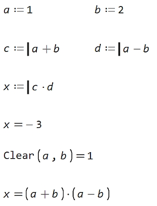

Hi. It needs. That is the mean for a:=a and b:=b, which clear a and b only for symbolics, but not for numerics. If you want to show the symbilic value stored in x cleaning a and b after you define x, you can use line() in the definitions:
Also notice that you need to eval Clear(a, b ) = 1, if not SMath not recognize that as an instruction.
