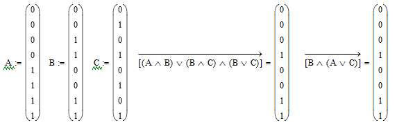

I want to use Boolean expressions with vectors, but I cannot find a way of doing this. It is relatively simple with Mathcad, but I want to use SMath Studio, as I am a student, and I am trying to show other students how to simplify logic circuits using Boolean algebra.
For example, the circuit described by ( A&B )|((B&C)&(B|C)) can be simplified to B&(B|C). I want to be able to call the three vectors (A, B, C) and have the output of the two expressions shown as a vector of zeros and ones (in this example the output vectors are the same as the simplified second-expression is the equivalent of the more-complex first-expression.

Unfortunately, as I am showing other students how to use logic, I wanted something simple for them to use. In Mathcad 15 it is easy to show an original expression, and alongside it a simplified expression resulting from using Boolean Algebra, and I was hoping that SMath Studio would do the same, as I do not expect my fellow students to pay for a copy of Mathcad. Unfortunately, SMath Studio does not have to option of a simple use for logic on vectors as does Mathcad 15 (see attached .jpg image from Mathcad 15 - I hope this works, as this is the first time I have tried to attach an image).

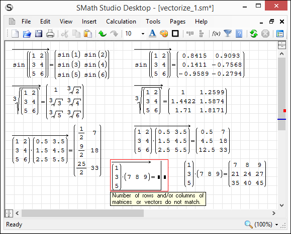

WroteFYI, I'm currently working on this feature.
Yes, please, thank you Andrey.
Maybe next: fft and picture operator.
In the mean time, "Vectorise EXPRESS"
for user to adapt wrt applicable project
Utilities Matrix Vectorise EXPRESS.sm (27.61 KiB) downloaded 1213 time(s).
Regarding initial question: see vectorize(..) function into new nightly build release: http://en.smath.info/forum/yaf_postst7329_SMath-Studio-0-98-5908--05-March-2016.aspx
