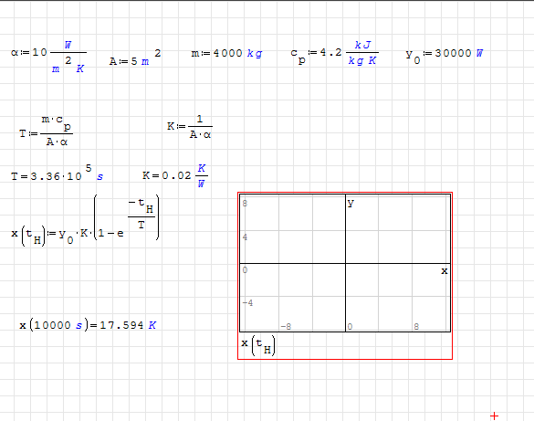

I made several attempts to draw a function as 2D plot. Somehow I have always bad luck. Can someone tell me what I must do to succeed?
Kind regards
Gaselhul

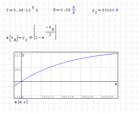

The variable you want to use as abscissa in the plot must be called x (when used in the placeholder). So you have to write x(x*'s).
More informations in the wiki: Graphs

Get used to plot in Smath.
Stuff Plot Primer.sm (19.66 KiB) downloaded 1197 time(s).

Dear Davide, dear Jean
Thank you for your support. Now I am able to plot the function.
