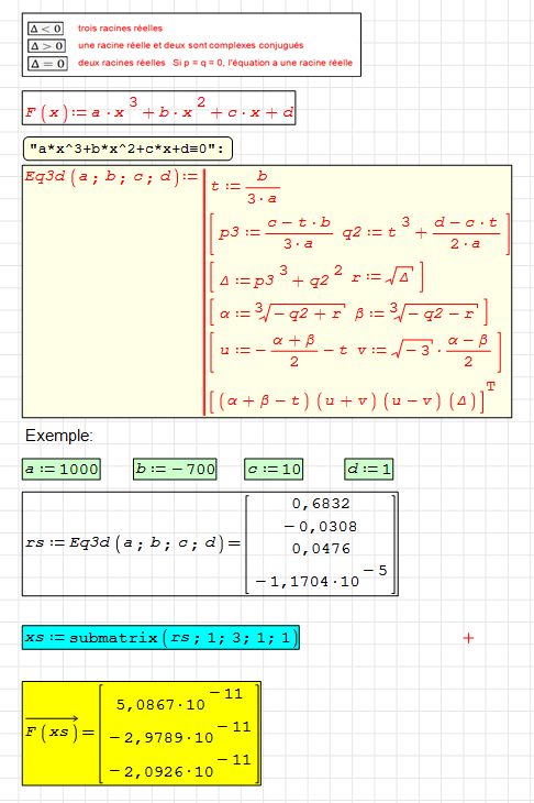

Hi JJ,
Here is a solution:
Ioan

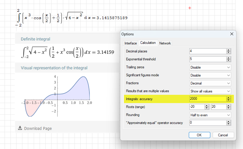

int((x^3*cos(x/2)+1/2)*sqrt(4-x^2),x,-2,2) is calculating incorrect
#6 Posted: 2024/4/2 15:48:37
1,435 likes in 2,913 posts.
You have to play with the "Integrals accuracy" global setting (Tools > Options... > Calculation)
