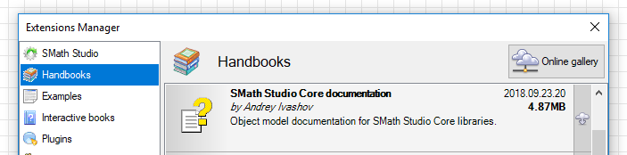

SMath Studio Core documentation updated

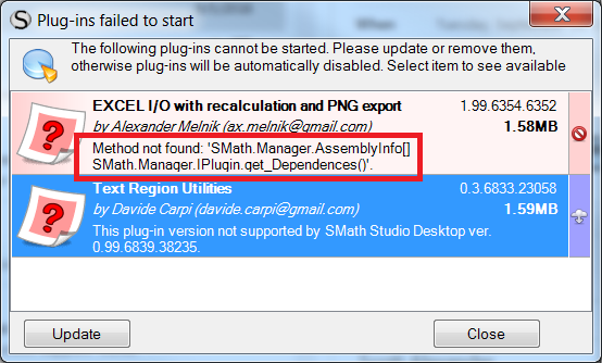

In this version I get following error for the Excel plugin
What would it be caused by?
Thanks!
In the repository I've already updated the code some days ago; if the plugin linked in my post works for you we can release the plugin (I can't test it directly in these days).
This worked well, thank you
Thanks!
What is the status on this? I had the same problem with the plugin last month and rolled back to the previous version.
The plugin was updated at the begin of the month, it is published as beta.
