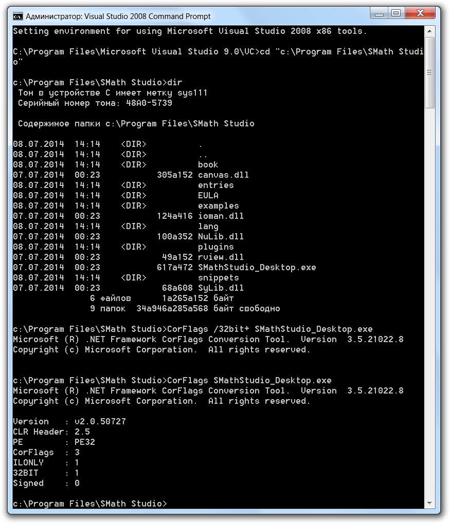

SMathStudio_Desktop_0.97.5189_32bit
How to get this 32-bit version (MSVS2010):
CorFlags /32bit+ SMathStudio_Desktop.exe
I'm not a programmer, so VS2010 is not a good option. Simple patch is preferable
So far the flags bits are at the same location for all SMath versions.
Just use HEX editor to write one byte 0x03 to absolute address 0x00000218 in the SMathStudio_Desktop.exe.
Good luck !!
Good luck !!

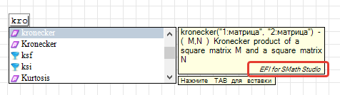

30.05.2020 03:11:45 [INFO ] [Plugin.Initialize()] EFI for SMath Studio, version 1.0.7165.40625, 14-авг-2019 22:34:10
30.05.2020 03:11:45 [INFO ] [Plugin.Initialize()] Psi(1) - ( z ) Digamma function for complex z
30.05.2020 03:11:45 [INFO ] [Plugin.Initialize()] kronecker(2) - ( M,N ) Kronecker product of a square matrix M and a square matrix N
30.05.2020 03:11:45 [INFO ] [Plugin.Initialize()] Successfully. 2 function(s) loaded.

Step 0. Copy CorFlags.exe to the program folder.
Step 1. Start command console with administrative privileges.
Step 2. Move to the program directory:
Step 3. Set the 32-bit flag to 1 (don't forget about spaces):
Step 4. Check the flag value (32BITREQ must be 1):
Result:
Command to return back 32-bit flag value (32BITREQ must be 0):
cd "c:\Program Files (x86)\SMath Studio"
CorFlags.exe /32bit+ SMathStudio_Desktop.exe
CorFlags.exe SMathStudio_Desktop.exe
Result:
Version : v2.0.50727
CLR Header: 2.5
PE : PE32
CorFlags : 0x3
ILONLY : 1
32BITREQ : 1
32BITPREF : 0
Signed : 0
CorFlags.exe /32bit- SMathStudio_Desktop.exe

Thank you for the clear instructions. I have the EFI working (e.g. kronecker works). However, the prode test file still doesn't work. I'll continue in the Prode Physical Properties thread.
WroteI have the EFI working (e.g. kronecker works)
... kronecker & Kronecker are built-in native Smath.
WroteWroteI have the EFI working (e.g. kronecker works)
For my installation, kronecker only works if the MathcadEFI is enabled.
