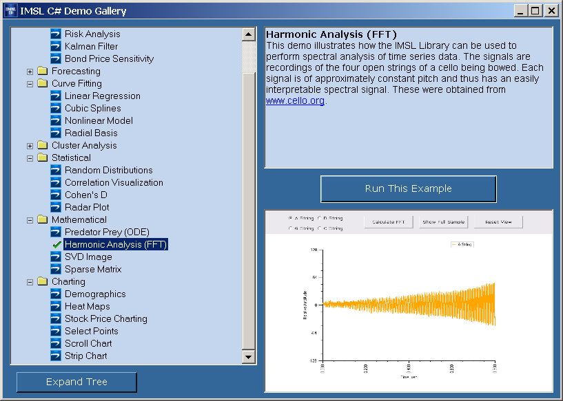

There are well-known IMSL® Numerical Libraries. Many people use this library, but it is commercial. This library exists in different versions (c# one of them). It can be used to extend SMath Studio.

It's not so hard to use IMSL library now. Simple example (c#) - calculating special function (Imsl.Math.Sfun) Gamma(x):
Show Spoiler
The program requires some additional files: ImslCS.dll, LicenseFlexLM.dll and license.dat
Radovan Omorjan 2013/6/21 10:30:00
