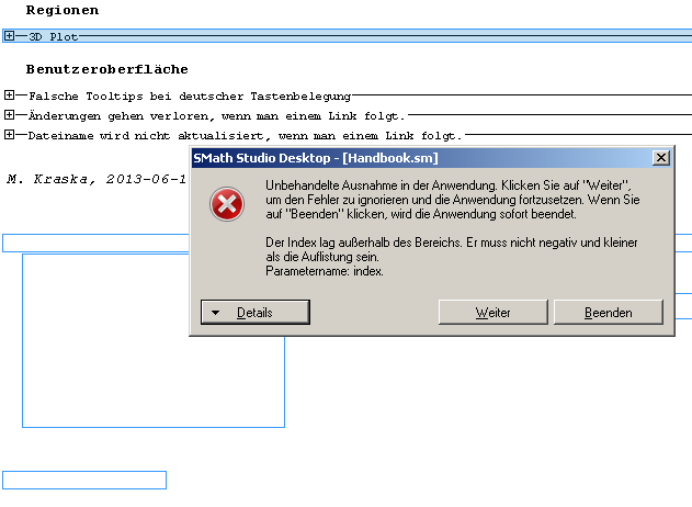

SMath Forum SMath Studio Bugs & Problems Copying a closed area region crashes SMath 1 Pages (2 items) Copying a closed area region crashes SMath - Messages Go to last post #1 Posted: 2013/6/16 08:58:47 Martin Kraska 1,355 likes in 2,271 posts. Group: Moderator Using Ctrl-Drag to copy a closed region crashes SMath.You can just save the (spoiled) work, but no further editing possible.Edit: Seems to be fixed in 0.97.5189 Technische Mechanik mit SMath Studio: https://link.springer.com/book/10.1007/978-3-658-50592-9 #2 Posted: 2013/6/16 09:24:47 Radovan Omorjan 325 likes and 1 dislikes in 2,052 posts. Group: Moderator I noted that that the closed Area region can not be moved, and I took that as granted. The CTRL+Drag of closed Areas scrashed SMath, that I can confirm as well.Regards,Radovan When Sisyphus climbed to the top of a hill, they said: "Wrong boulder!" 1 Pages (2 items) New Posts No New Posts
