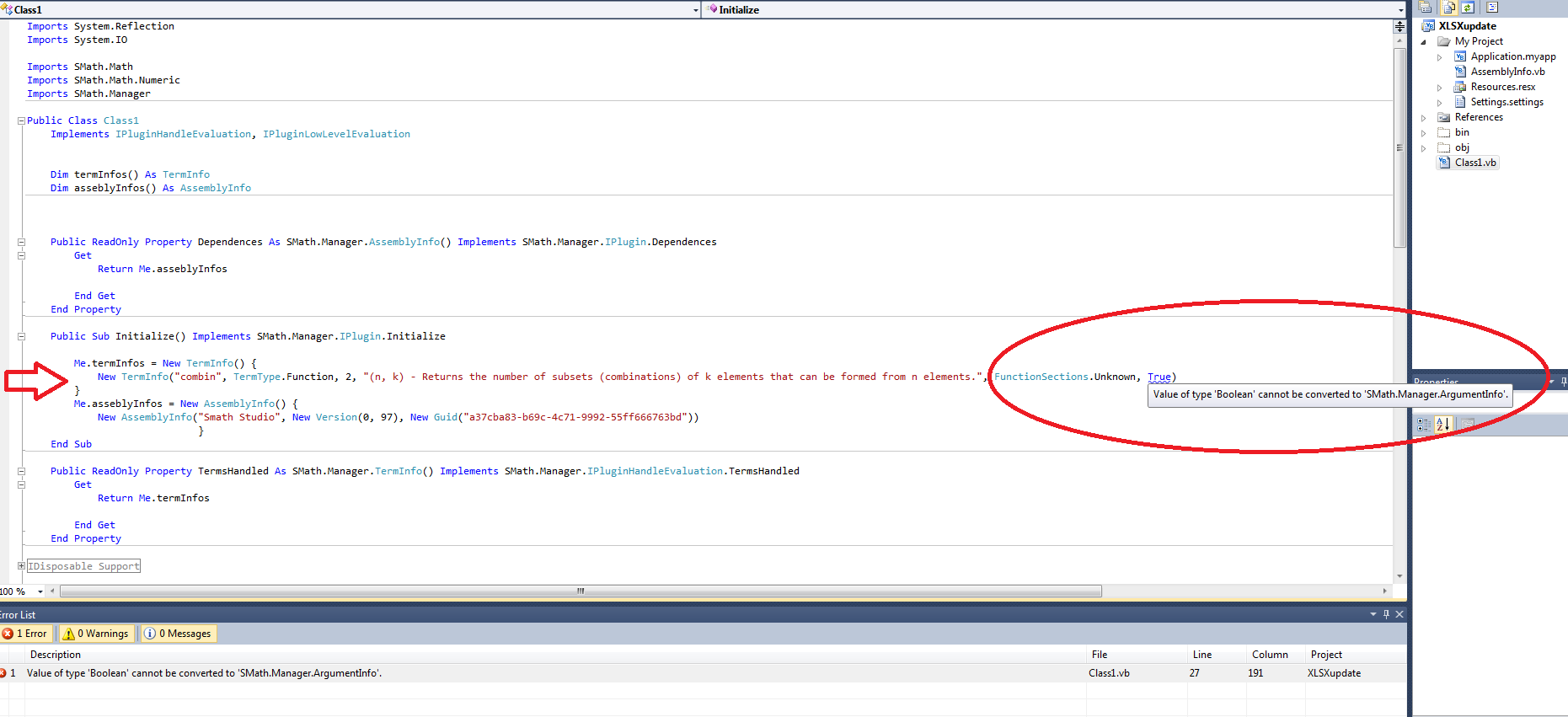

Good day,
I am attempting to follow through tutorial on plugin development in VB.NET:
https://smath.com/wiki/GetFile.aspx?File=Developer%20Guide/Tutorial%20on%20creating%20plugin%20for%20Smath.pdf
I have not reached a glorious conclusion yet, however even now I can notice something to be incorrect (see screenshot).
Could someone please point out what I am doing wrong? Please keep in mind that I have never attempted to piece few lines of code together before and hence might miss obvious things. I am attaching my project folder.
Thanks!
Thanks!

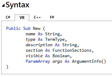

You have to delete the third argument (old syntax, I guess)

New TermInfo("combin", TermType.Function, "(n, k) ‐ Returns the number of subsets (combinations) of k elements that can be formed from n elements.", FunctionSection.Unknown, True)
