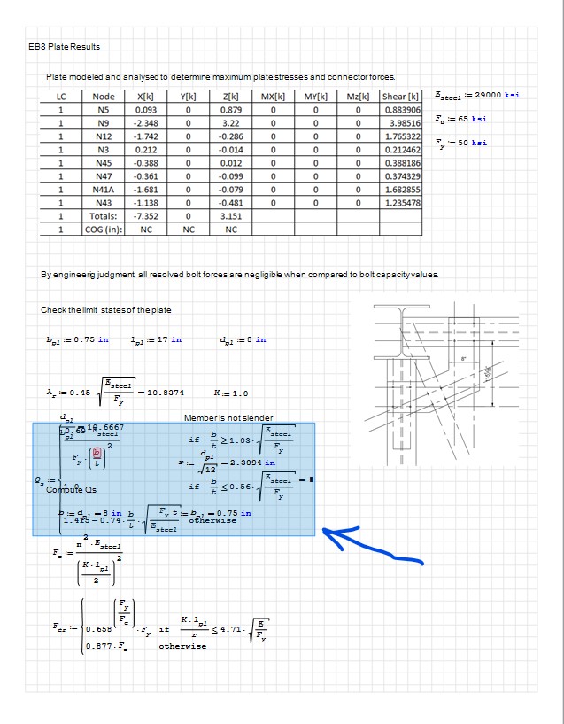

I am not sure how to describe exactly, but when I try to paste images into the scratch area on the right, SMAth starts to auto paginate and prevents me from manually move the graphic over.
Here is a screenshot.
screenshot
I do not remember this behavior. I am used to piling up screen snips and the like on the right as references as I work.
I wonder if one of the text plugins is kicking in, but which one? PRConn1.sm (1.09 MiB) downloaded 1382 time(s).
Dennis

The reason is in your third image (according to what I see on the screenshot).
The rule is: your regions should always be located in the vertical bounds of the page, even if it is a scratch area.
Because of the size of your 3-rd image SMath Studio cannot display it in the vertical page bounds (space of the first page just not enough for this). That is why SMath Studio automatically reduces available size of the first page (notice a gray area) to put this 3-rd image (and all content with larger y-coordinate) to the next page.
Solution for you is to make the image smaller.

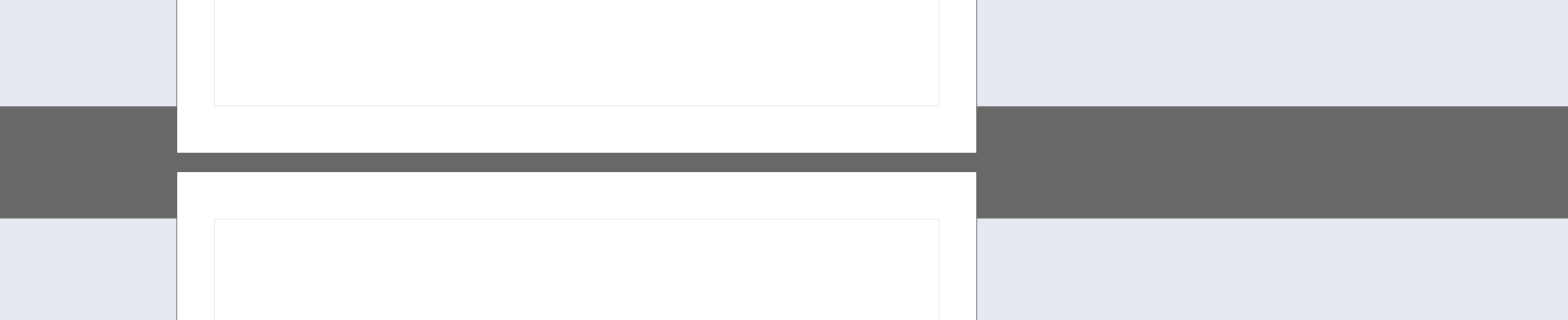

Maybe we should make the background out of the bounds different where stuff can't be placed, like in the image below, so it will be easier to spot when something hits the bottom marggin in the RHS zone.

I know it's a challenge to implement, but I think the ability to put stuff in the RHS is really important for annotations, documentation, secondary sanity checks, ideas, etc... Anything that should not be seen on printed or exported files, like what it is possible to do in excel or ppt. At least it's how usually I arrange my documents.
In practice LHS content should drive the pagination, RHS regions should bruteforce split crossing regions and continue in the next page RHS.
As side note, to improve the LHS pagination, as you suggested some time ago, being able to set a grid of break points in the regions would be nice too (but this no matter of the thread 🙂)

Let's say the comment of the first region has a bigger height that fits in the dark gray zone of my picture above; in the initial state there isn't problem, but if you move down the regions to the second page, the second comment will be hidden by the first. For the same reason you cannot create regions in that space (this zone in the end is the dashed line between the pages in printing bounds view, an imaginary range of coordinates between the bottom edge of the first page/region and the top edge of the second page/region, where should they be moved respect to the others when vertical space is added or removed above them?).
In the end having stuff drawn in that area and then editing the worksheet what you'll experience on the RHS vertical spaces appearing or overlaps, and that zone where regions cannot have origin but has no clear gui; that's why my suggestion to grey out that zone.
One might want the rhs like a continuous blackboard, but in that case the cost is to lose the RHS/LHS vertical link; it's ok on a locked LHS layout, but once you start moving things around, becomes a problem.

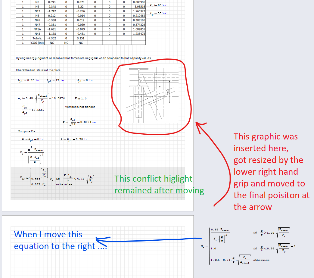

I am not sure if this is the same issue, but when I try to resolve a bounds conflict, the highlight region is still in effect and then SMATH moves things in a way that I do not understand. It clashes with things on the previous page.
Any ideas?
Any ideas?
Hello.
It is really hard to understand what is going on here, but I would suggest you to select a region you are talking about and try to move it up/down using keyboard arrow keys. This will help you to understand the logic under the hood.
Please note: we are still have a positioning issue when moving regions with a mouse in Page mode (if you will move a region by mouse from one page to another), so something it is easier to use keyboard.
