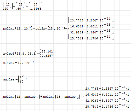

I might be wrong but SMath does not calculate sum of vectors given in polar coordinates correctly

Actually, there are several ways to calculate vector sums. In 2D the most natural way for vectors given in polar form is using complex numbers. In mechanics, we usually transform to cartesian components, as this can be generalized to 3D.
Unfortunately, this example reveals that the handling of sums in Maxima plugin is very weak at the moment. Therefore, we have to "surrender" for the moment.

I think you are right; BTW is a quite simple problem, so one can build his own function, with the most appropriate input standard that he think better and, like has Martin said, there are several ways to process the problem
WroteNote that SMath does not return the correct result.

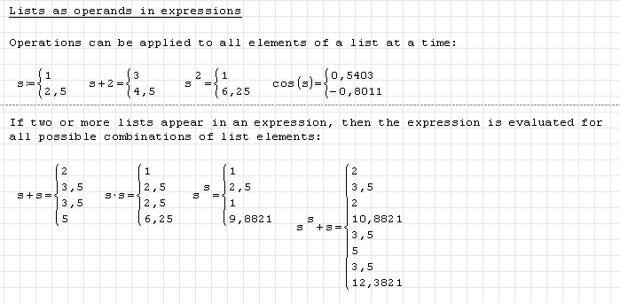

Lists and list operations are not a good representation for vectors and vector operations. If lists obtained by pol2xy are to be added, they must be converted to vectors using sys2mat().

I forgot to apply sys2mat to an expression involving more than one system, anyway the result of that sum is incorrect.
