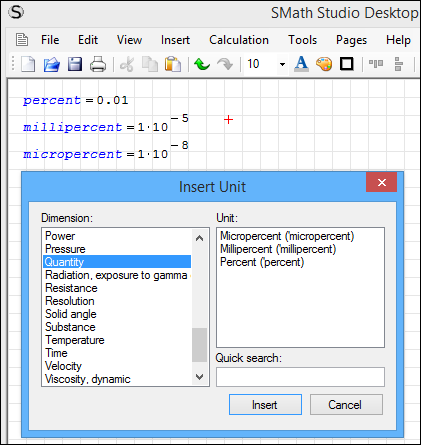

How can I specify the "quantity" dimension, with percent just being a unit representing the factor 0,01? I do not see a place for the word "quantity". Could you please give a template for percent, then I should be able to do the rest.
#7 Posted: 2014/6/17 18:36:39
2,340 likes in 4,041 posts.
Here we can assume "quantity" is just a property. So, we can say 'percent' unit is dimensionless (it equals to 0.01). Note, based on Units.xml dimension for dimensionless units has id="613". Then, here is an example:
<?xml version="1.0" encoding="utf-8"?>
<entries lang:default="eng" xmlns="http://smath.info/studio/entries" xmlns:lang="http://smath.info/studio/entries">
  <units>
    <property dimension="613" title="Quantity" lang:rus="Количество">
      <add factor="1" exp="-2" system="All" title="Percent" lang:rus="Процент">
        <synonym name="percent" />
        <extension for="percent">
          <prefix name="micro" title="Micropercent" lang:rus="Микропроцент"/>
          <prefix name="milli" title="Millipercent" lang:rus="Миллипроцент"/>
        </extension>
      </add>
    </property>
  </units>
</entries>
Note: screenshot taken from the newer build then available for download. In SMath Studio 0.97.5280 "quantity" units will belong to "Dimensionless" group.
