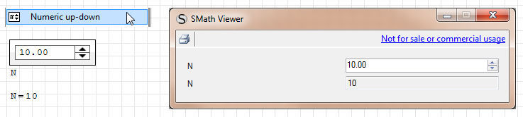

    - Allowed inputs: region up/down buttons, + and - keys, mouse wheel; hold the input to have more increments.
    - Settings: double-click over the region.
    - Output: place a variable in the region placeholder.
    - Size driven by the value (manual resize not allowed).
    - Adds the same control in SMath Viewer.

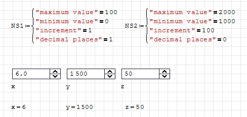

Something like in the attachment? The entry point for the variable would be the form (like in table region) or in the context menu (like in the modeller region); this should grant customizable settings for every region, when you have multiple regions.
ioan92 2015/10/8 10:58:00
#9 Posted: 2015/10/28 11:55:55
1,443 likes in 2,935 posts.
PLUGIN UPDATED SMath Studio 0.97.5737
- Introduced settings from canvas (see attachment);
- History Undo/Redo now is supported;
canvas settings.sm (17.29 KiB) downloaded 1506 time(s).

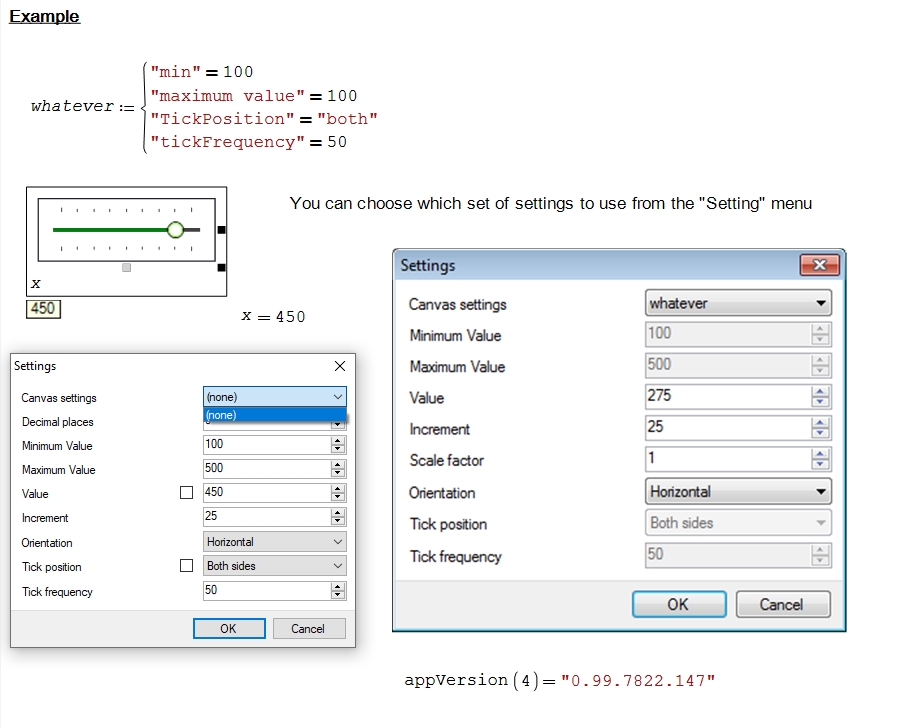

Hi, it seems that the "canvas setting" field does not recognize the "whatever" variable. I'm using smath in windows 10.Slider.png
#14 Posted: 2021/10/25 21:18:43
598 likes in 1,380 posts.
I think this can be a bug.
When a setting has a string value, it can not be read by canvas settings.
Delete the "TickPosition" = "both" and whatever will be readable again.
I have tried this with "orientation" = "vertical", whatever can't be read by canvas settings.
Deleted the "orientation" = "vertical" element, and it can be available again.
This behavior made me to think there is something wrong while reading strings.
#15 Posted: 2021/10/26 05:58:20
Thank you, confirmed. I'll fix it ASAP.
You are right, it is related to strings encoding. If you remove the space character from "maximum value" it works as expected.

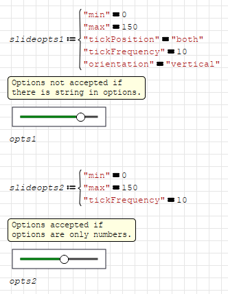

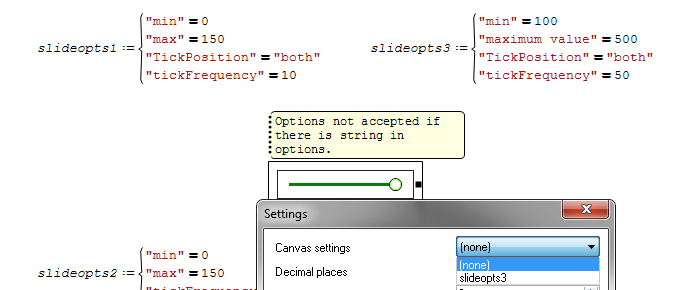

String issue not fixed, at least for linux.
slider_options.sm (4.55 KiB) downloaded 1387 time(s).
#18 Posted: 2021/11/2 05:58:47
Thank you, I can reproduce with your file even in windows... this issue it's something more subtle, though
#19 Posted: 2021/11/2 11:56:10
Found it. You forgot to set the optimization to "none" on definitions, as indicated in the documentation. If you hover over the definition you can see that in both numeric and symbolic optimization the boolean equal between strings is preprocessed and stored as 0.
