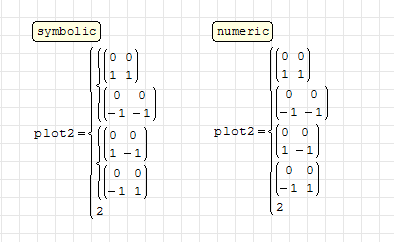

I have been trying to plot a matrix containing multiple matrices by using the mat2sys.1() function to convert the matrix into a system of matrix first. I got it to work once, but could not get the same result by using the same codes after. Please refer to the attached, I have highlight the code that works in pink. If I copy and paste that exact line of code, it would work but it wouldn't if I just type in the same thing, I have demonstrated that in my attachment. I hope someone will be able to shine me some light on this. Thanks!!!

You have to change the optimization of the plot2 definition to numeric, because the special features of SMath systems. You can see what happens by holding your mouse over the plot1 and plot2 definitions.
